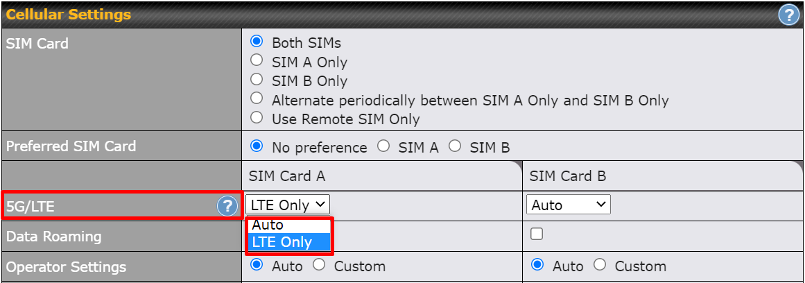

to be 100% sure. All of the new 5G modules for 20x or SDX will work with 5G AND 4G, right?
Is it possible to set a 5G module to 4G only?
Maybe @TK_Liew can give me the answer? In the first versions of the module it wont connect to 4G, that’s why I’m asking
Thanks
Dennis
@dennis.hofheinz, you are right, the Cellular settings page for the 5G module has options for “Auto” and “LTE Only”. With “Auto”, the module will attempt for both 5G and LTE connections, with “LTE Only” will fix to LTE connection.
