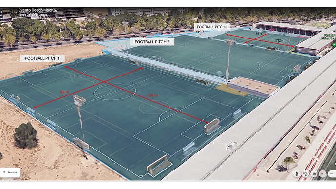

Recently, I have been asked to cover 3 football pitches with WiFi for an event with 1000 simultaneous attendees. They will use an app which doesn’t require tons of speed (500 Kbps up / down maximum). This sounds like a fun project, but I am afraid I may screw it, since I have more theoretical than practical knowledge in this types of setups.

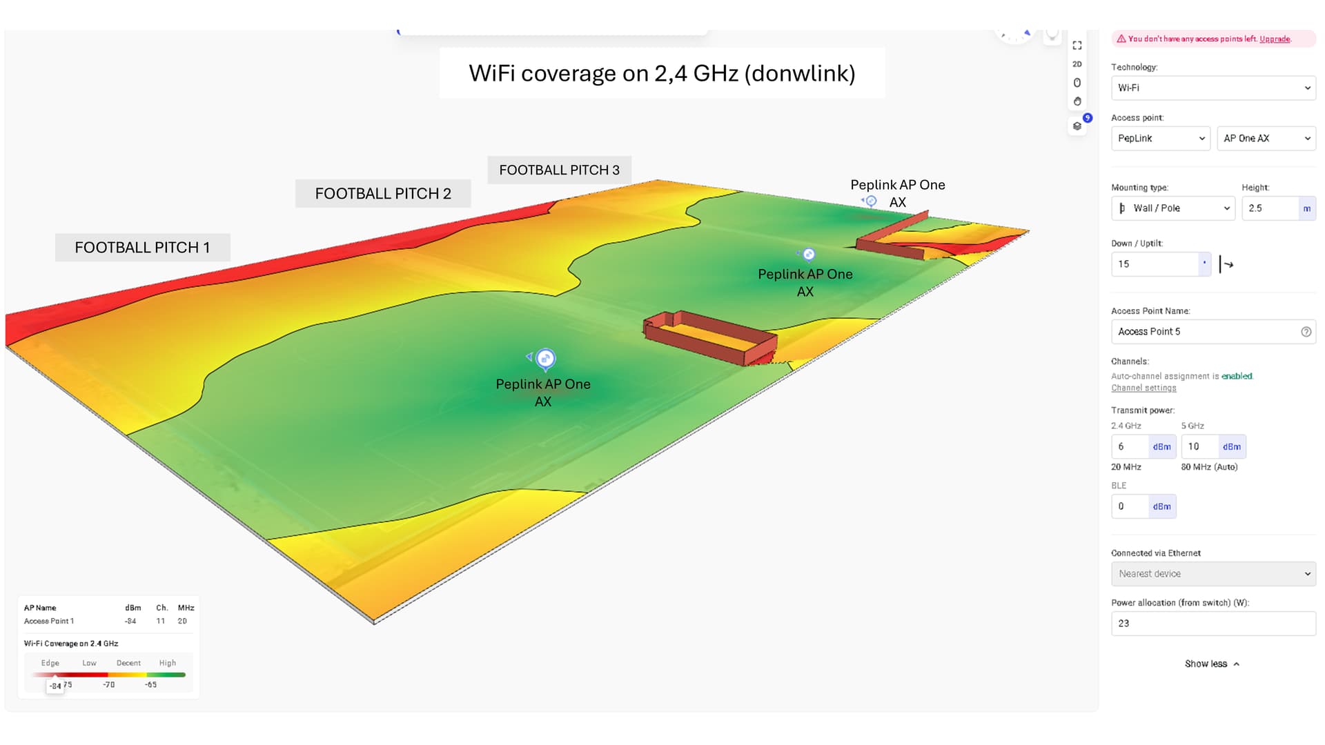

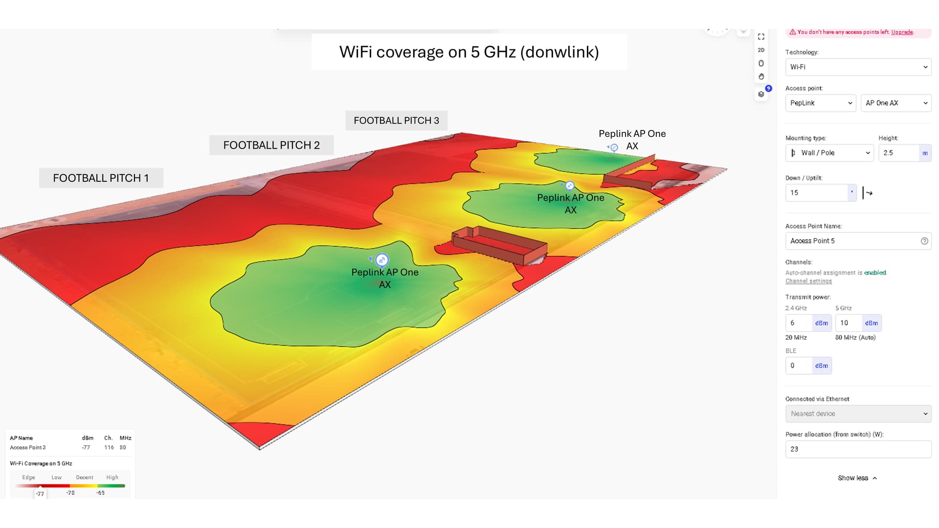

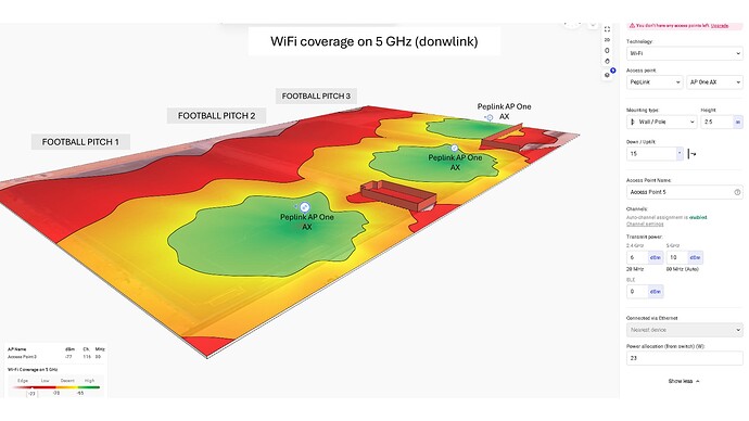

I am planning to use 1 x Peplink Balance 310 5G router + 3 x Peplink AP One AX access points, since this is what I own. I did some quick tests in Hamina, which I attach here. The results for 2,4 GHz could be sufficient, but 5 GHz coverage is poor, so I guess I would have to get more APs.

Not sure if you have seen it in Hamina but there is also an option to model human crowd, use it as it will help to simulate the attenuation that 1000 bags of mostly water create… you will find those coverage areas shrink a lot. :wink:

You also must consider calculations in terms of radios not access points and unless you are buying certain specific vendors products that means 1x AP = 1x 5GHz radio.
Don’t even consider 2.4GHz for any kind of capacity calculations here, whilst that site looks reasonably remote and probably has a relatively low noise floor in 2.4GHz it will almost certainly not have that when there are 1000 extra people there.
Plan your network as 5GHz only and enable a few 2.4GHz radios if it is actually required.
If we just consider simple maths and that a practical association target (number of devices you want on each radio) is probably going to be ~50-100 here you need 15-20 APs just to meet that target.
In terms of delivering ~500Kbps per client you are also probably going to want to target no more than 50-60 devices per AP to be conservative and give you some headroom in the design.
