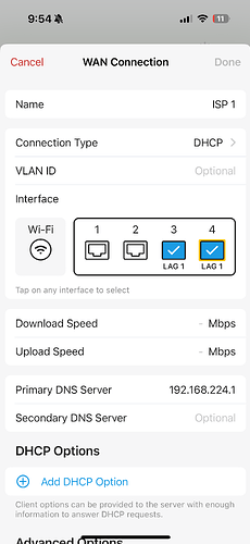

Here is how looks on some devices…
Called LAG - link aggregation group.
For example I have 2 active WANs connections and I want just aggregate this WANs connections and have better speed = (connection 1 + connection 2 ) on lan/wifi port without VPN.

B one comes with two ports, but can’t make it work

Can you share the Dashboard of your device?
Can you share the WAN2 details of your device?
