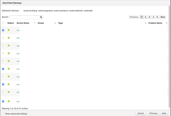

  1. In IC2 go to the configuration pane on the speedfusion tab.
  2. Pick the configuration to which you want to add a non-IC2 unit, and click on “Edit”.
  3. On the second configuration pane (labeled “End Point Devices” for a star configuration)/the first configuration pane (labeled “Peer Devices” for a P2P configuration) you will find a checkbox “Show advanced settings” in the bottom left corner.
  4. Click on the box and you get the option to add a device:
  5. Click on “Add Device” and you get the configuration pane (in this example the hub device is named “claremont”).
Proceed from there.
