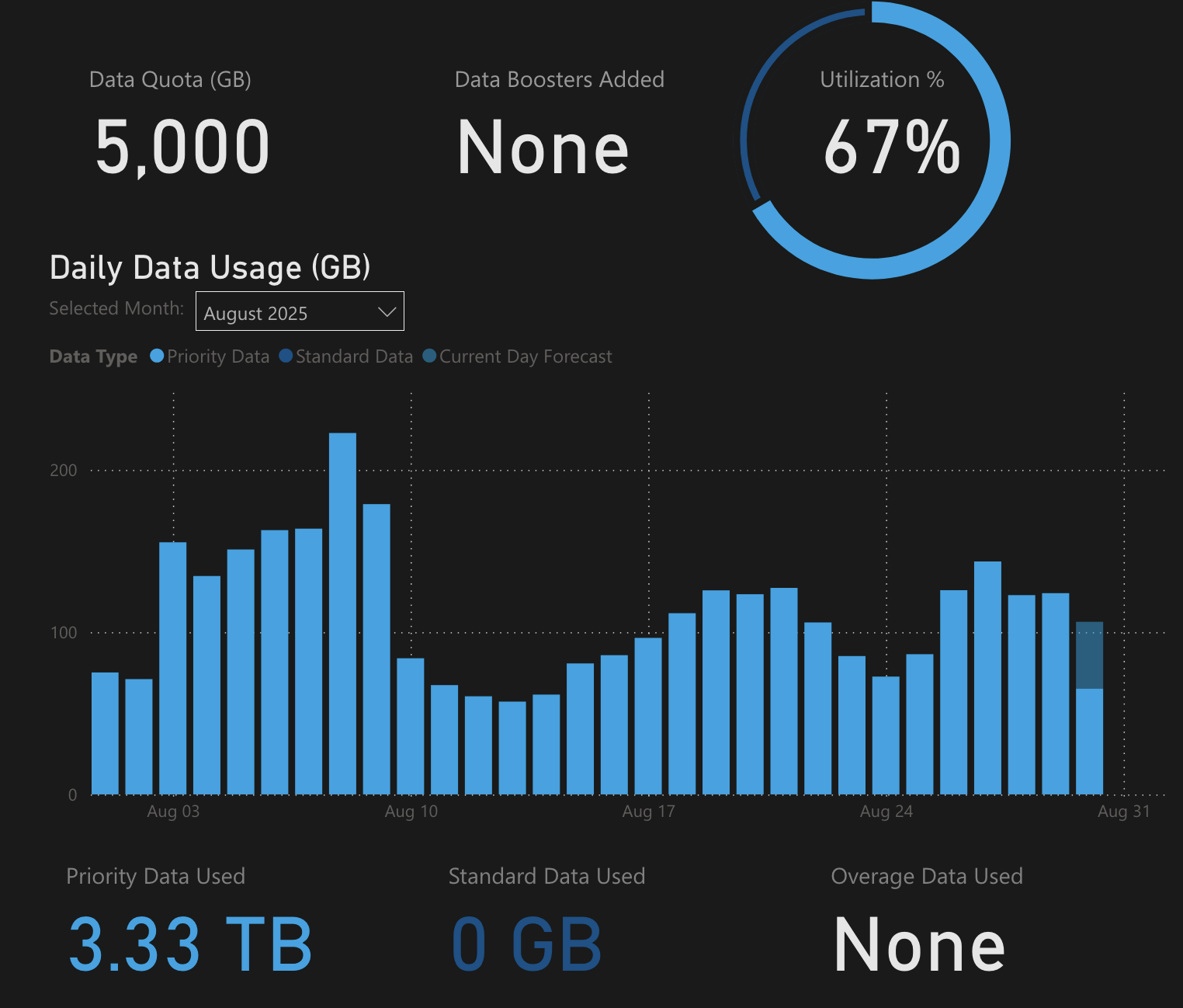

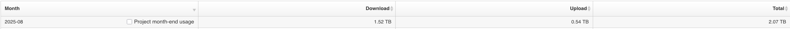

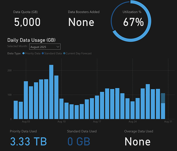

@Jonathan_Pitts Starlink configured to share 5TB over 2 Kits, hence the 2 WAN screeenshots. 3.33TB vs 2.94TB
I don’t see both wan screenshots for the peplink?

1st of the month for both Starlink and PeP. Have over 50 Starlink Kits on Pep routers and the usage differenciation is consistent throughout.

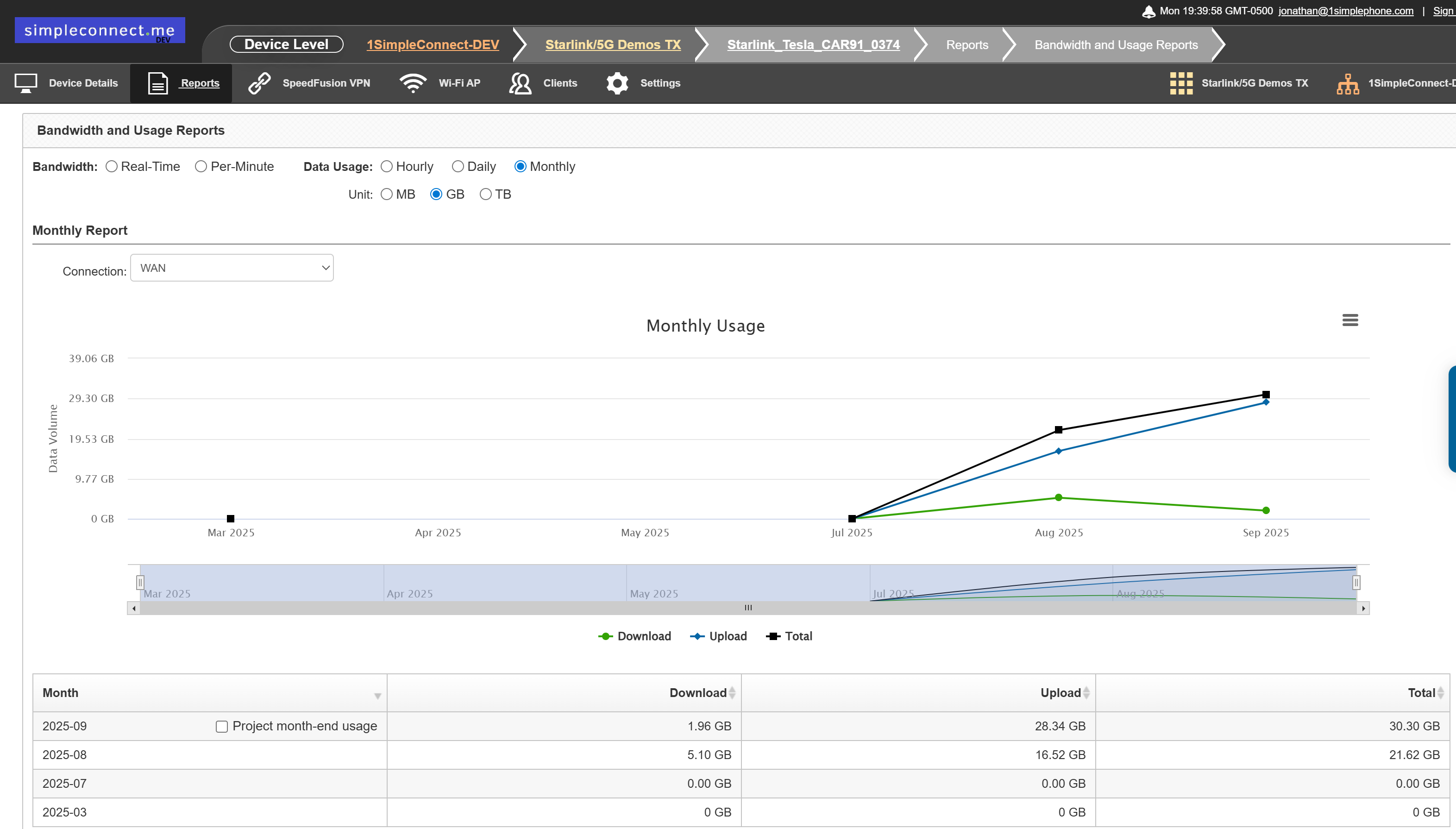

I did a quick check on the 1simpleconnect Tesla as @Matthew_Brownie suggested.
I was down in Houston so I only activated for the last few days of my billing cycle and promptly burned three 50gb doing only a few speed tests and some light browsing.
51.93 GiB Peplink IC2

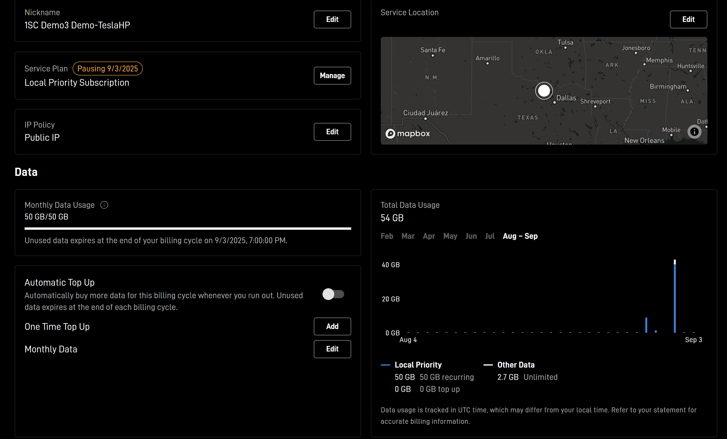

54 GB Starlink Website
