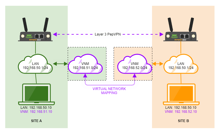

You could use Layer 3 with both subnets having the same subnet, then enable virtual network mapping so that each site thinks the other is available on a different subnet. Then on one site you would access the IP on the other site with the virtual IP instead. Then on each site you could use the firewall to block traffic to and from the remote sites virtual mapped network.

Ah in which case the LAN devices will not know to send traffic for the remote site via the Peplink. You will need to add a static route to the gateway at each site for the remote virtually mapped network with next hop as the Peplink LAN IP.
VNM at both Peplink routers worked for us. And now with PEPVPN+VNM we could work it out. Ping works.
