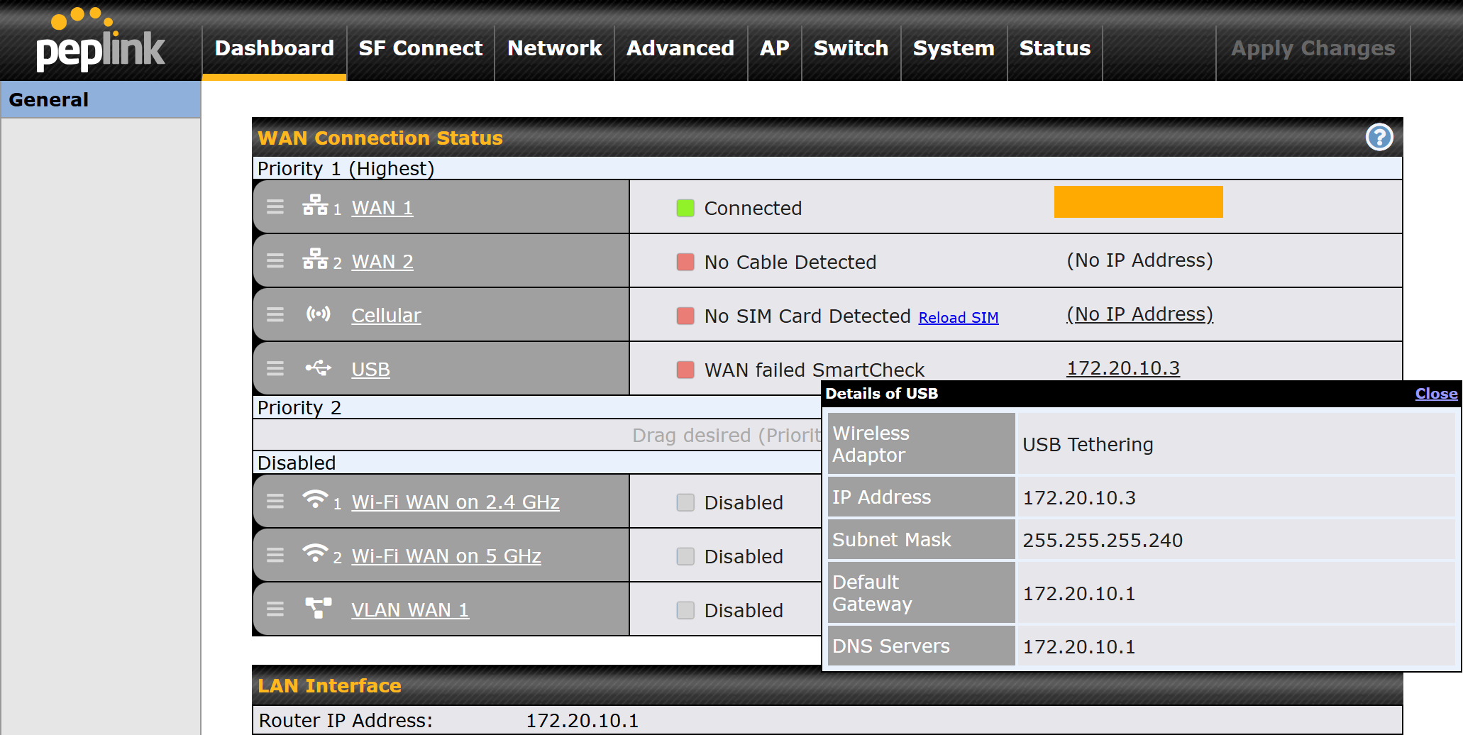

IP Confict issue to be aware of when using USB teathering
When the iPhone (and probally any USB modem or WAN) issues the same subnet as already used elsewhere on the routers networks (including VLANs), the USB connection will fail with errors like “WAN failed SmartCheck”.

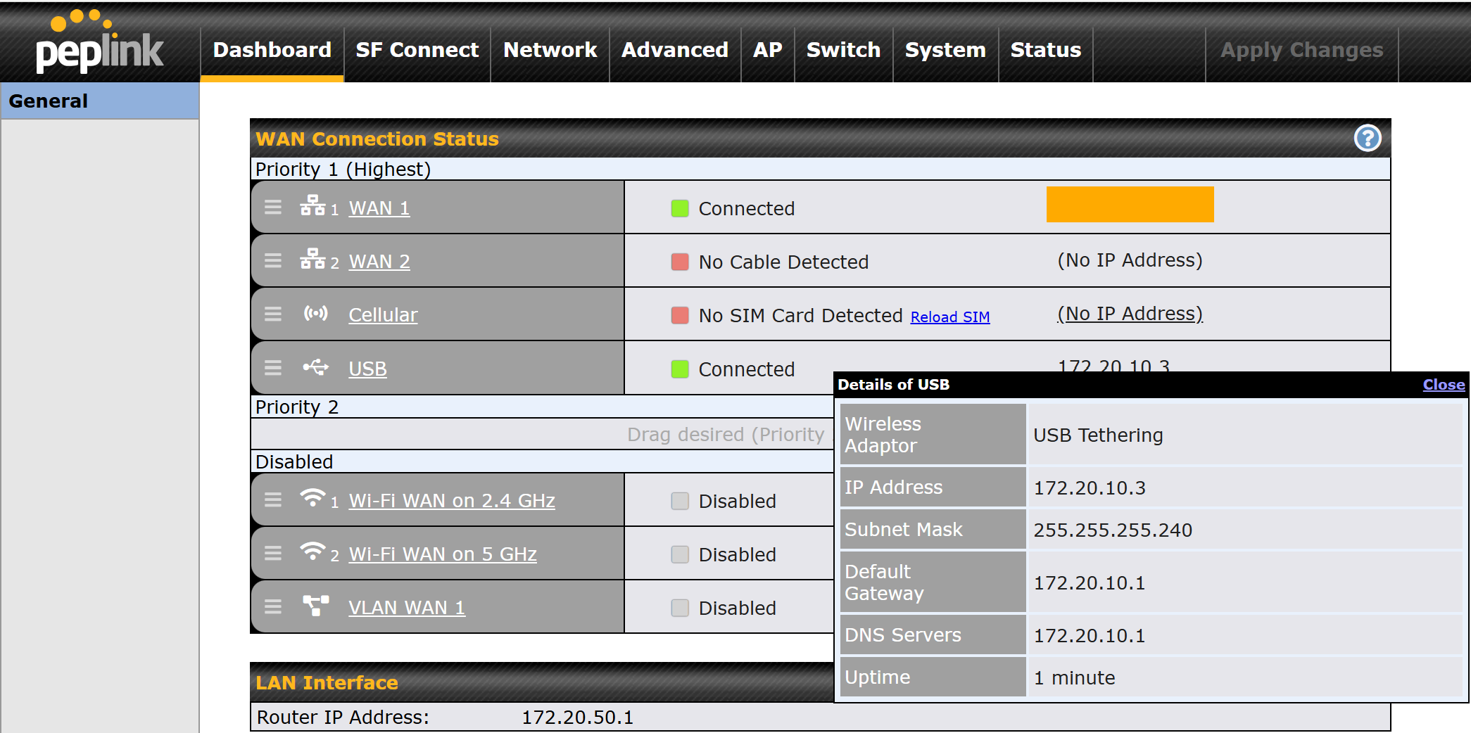

In our discovery today, the customer was using 172.20.10.x as the Untagged LAN, the iPhone issued its hotspot network on 172.20.10.x, so we changed the customers network to make the solution work.
Something to be aware of if you find your USB teathering is not working.

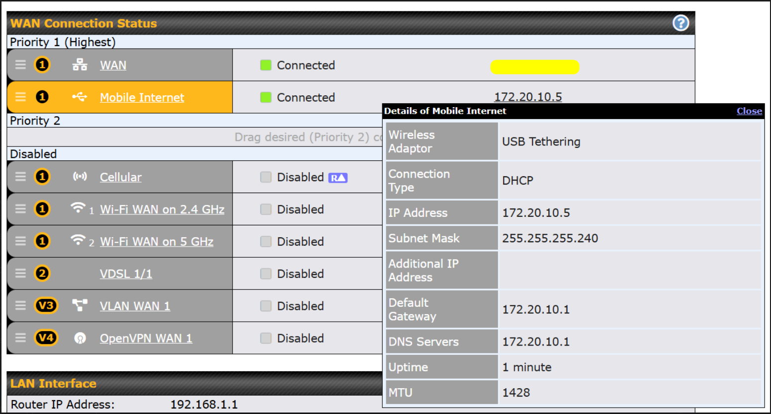

Another use for iPhone tethering. I have a spare chip, I can put in whatever device I want, either one of the routers, or my iPhone, or my Android phone.
When I’m traveling abroad, I’ll buy the data package for it, and I can put it in the iPhone, or the router as needed. With the iPhone tethering support, I can just leave it in the iPhone, if I want data on the router, I just plug in the iPhone. More convenient that way than swapping the chip.
