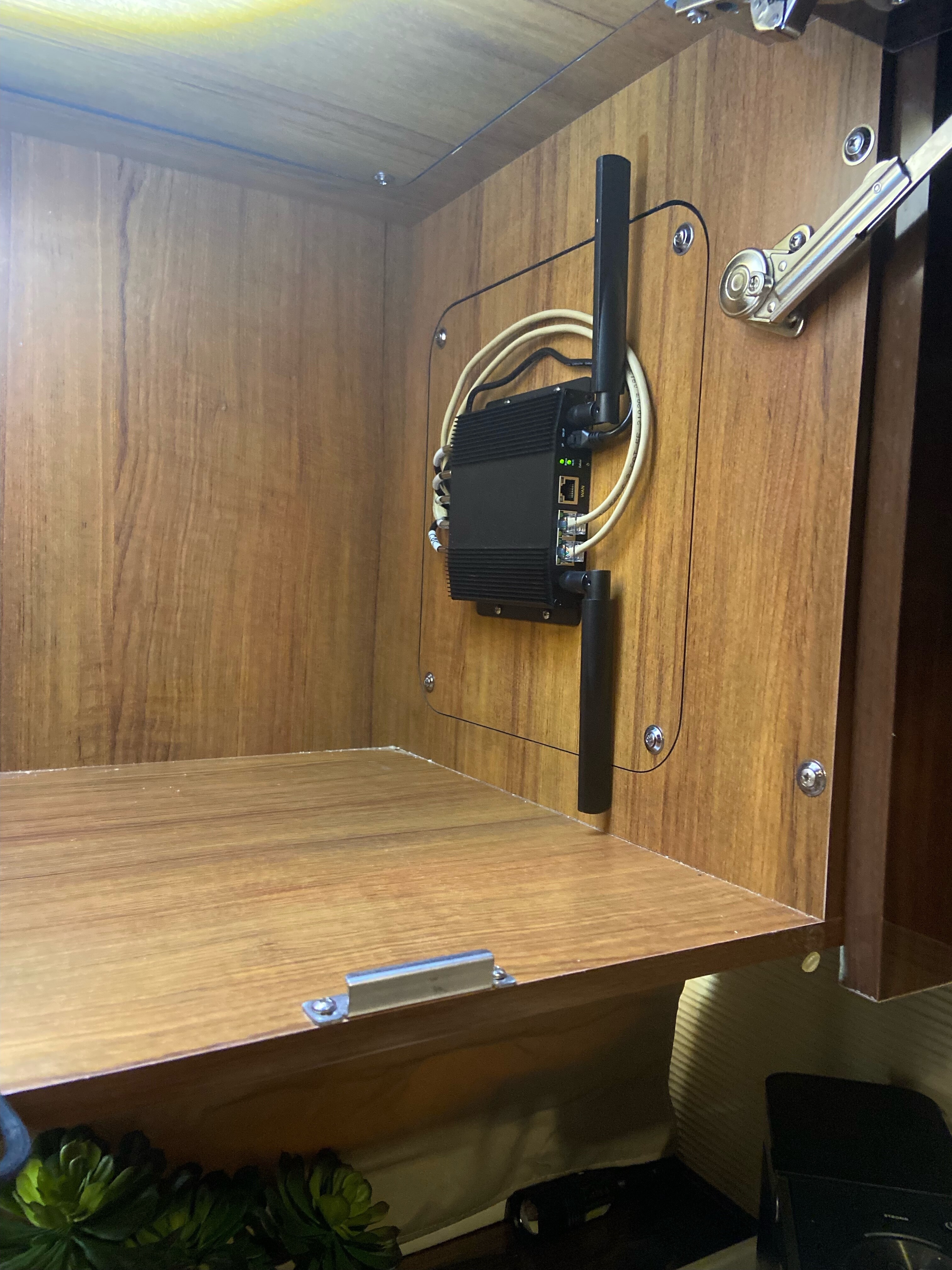

We have a MR 40G rooftop mounted with 15’ Peplink extension cables to our Balance 20X.
configured with (1) LTE AT&T card and marina WiFi
oddly we have better performance (up and down speeds) with the (4) paddle antennas versus the MR 40G (4) cables connected.
is there possibly an incorrect setting, failed antenna, too much loss with 15’ extensions?
Thank you for the response.
We are using LTE so we are only using two Antennas (Sim Card At&T) to the 40G attached to the front of the Balance 20X and two antennas on the back of the Balance 20x for Wifi (Marina).
Does that change your opinion?
Hi Richard,
hard to say why you get worse test results. Below are few thoughts to share.
Cables add attenuation and degrade the signal, but if the antenna is placed on the roof top, while paddle antennas are inside, then it should compensate cable loss.
Things I would do is to check the SMA cables are not loose. When the SMA connectors get loose, the attenuation rises exponencially.
Next, small advice, when we carry on testing we check what bands are used when modem connects to LTE network. Also it is possible to check the cellular tower ID. This is important as then you can compare apples to apples.
If MB-40G was used for Wi-Fi, then I suppose you have used used adapters in between as the you would need to convert from SMA to RP-SMA. Is that correct? BTW this has nothing to do with Cellular performance.
