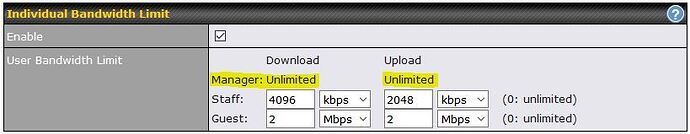

Create Usergroups:
Now only Manager, Guest and Staff is available. Would be great to create usergroups and rename the current.
And use the Individual Bandwidth Limit for the new created usergroups.

Individual Bandwidth settings per Wan link
For instance we have a Broadband connection 100/100 the Individual Bandwidth limit is for guest 2/2
Now we switchover to a satellite connection 2/2 ten the guest limit is still 2/2.
We do not get the wanted results from the group bandwidth Reservation, the limit does the job.

The wan speed is expensive sometimes, since you can’t really limit manager and cannot create new user groups this would be great if it works. It does for the upload. Sometimes we just want to set it lower to get grip on the cost.
