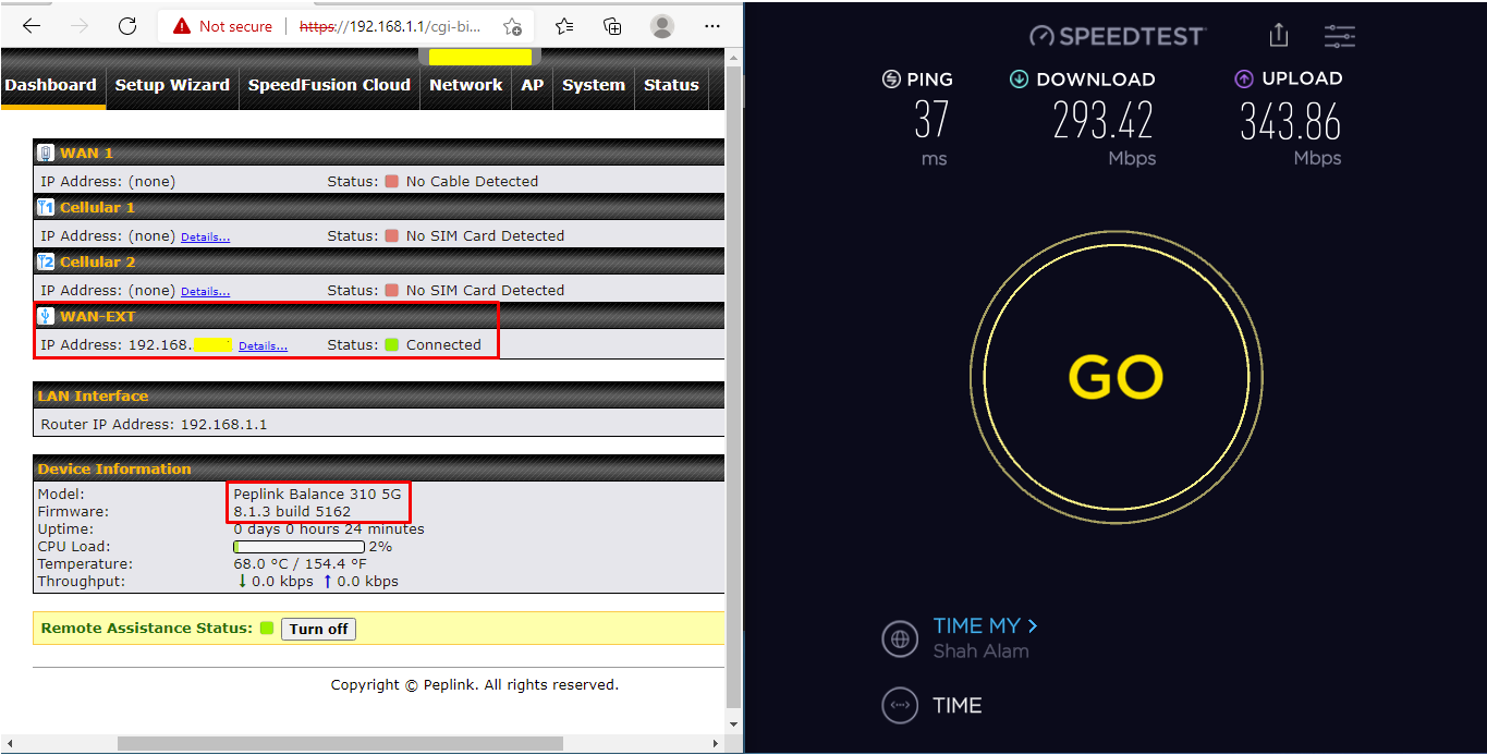

I tested on our B310-5G with firmware 8.1.3GA, it looks normal. I did a quick speedtest.net via the USB-Ethernet WAN, which gives me around 300Mbps DL/UL.
NOTE:
To “unhide” the USB-Ethernet WAN, you may refer to this FAQ.
