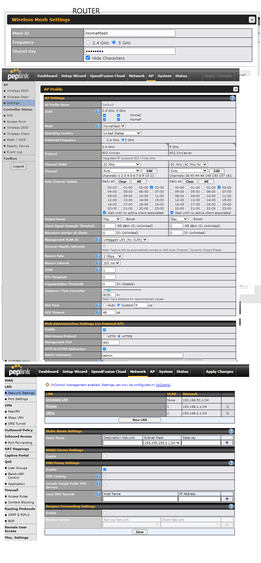

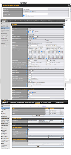

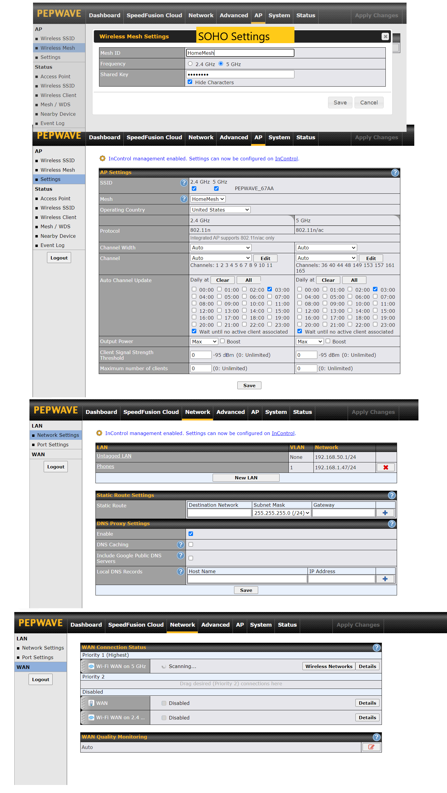

I have been trying to mesh my Balance one to a Soho MK3 for several days with no success. I have see similar question with this same combination in different forums with less than clear solutions. I have even reset the units back to factory and tried going forward from there. This is what I am trying to do.
(Peplink Balance One - 8.1.3 build 5172) connected over the WiFi to my Soho MK3 with the same build FW.
I have** **configured the Wireless Mesh on both to be HomeMesh , 5Ghz, with the same shared key. But nothing will connect.
The question I have is what does the SOHO MK3 use for a WAN in this case? Since there is nothing upstream WLAN connection. Do I need to do something special here to give it something to connect to or should it automatically connect via the SSID HomeMesh? I do have some VLANs. Do I need to change something on the VLAN to allow the configuration of the SOHO?
Below are both device settings. Any suggestions?
