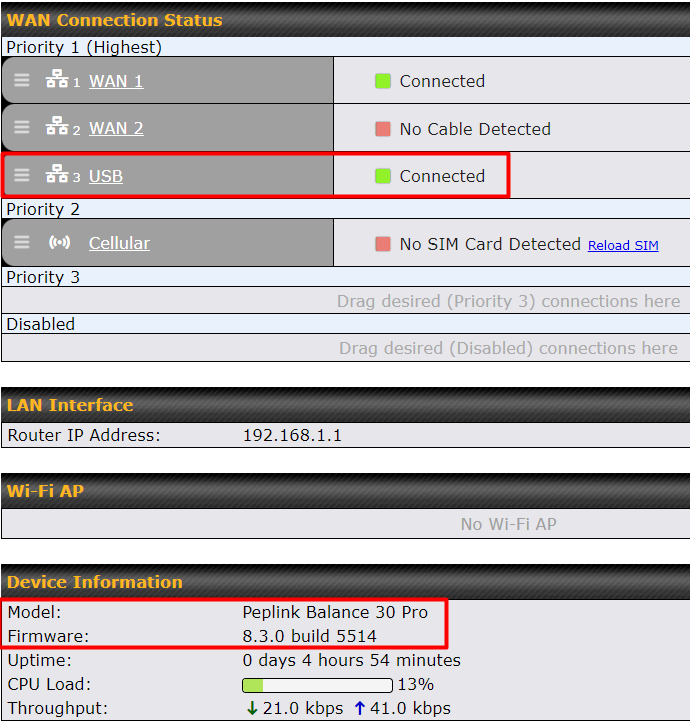

Our lab device seems working fine in firmware 8.3.0, with this USB 3.0 Gigabit Ethernet Adapter.
As suggested by @Rick-DC, please submit a ticket (with the USB-Ethernet adapter connected) and download a diagnostic report (in firmware 8.2.1 & 8.3.0) for us to verify the device condition. Do quote this post in the ticket too, as a reference.
