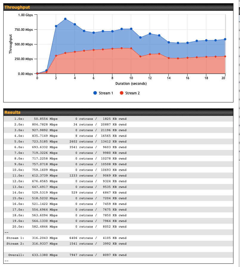

i ran the wan analysis, in the early hours of the night, but i didnt understand the result as it seems to think 1 link is 700+mb?

So the issue is that you have packetloss when sending raw traffic over both fibers at the same time. When in a speedfusion tunnel, the algorithm by default favours the lowest latency paths with the least amount of packetloss.
To tune this, use Dynamic Weighted Bonding, set the congestion mechanism to latency only - not packetloss and latency, and set FEC to high. (disable TCP ramp up)
Then send loads of traffic over the tunnel. Pay very close attention to latency of each WAN as the next step is to fine tune the latency cut off per WAN to reduce the impact of buffer bloat.
FEC will help replace packets that are lost, Latency cut off should limit jitter / buffer bloat and I expect you’ll see 420 - 450Mbps of stable, very good quality bandwidth over Speedfusion. If you want more bandwidth lower FEC to medium but keep an eye on resultant packetloss in the tunnel.
