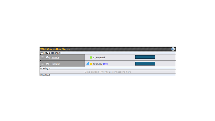

Whelp…The reboot didn’t clear and still throttled on Cellular WAN…
I reverted back to GA and now the SIM is in Standby state even though still in a Priority 1 position.
Seems like a few bugs to work out still. Maybe 8.5.3 will solve this? I fear a factory reset is what will be needed next to clear this up. Which is a bummer for sure.

Thank you @sitloongs. I replied back to the ticket.
For general knowledge in this post, I downgraded to GA 8.5.1 and then upgraded back to GA 8.5.2 and that cleared up the SIM being forced/locked into Standby State while still in Priority 1. That action also lifted the throttle.
When I have some time, will try again and see if I can duplicate.
