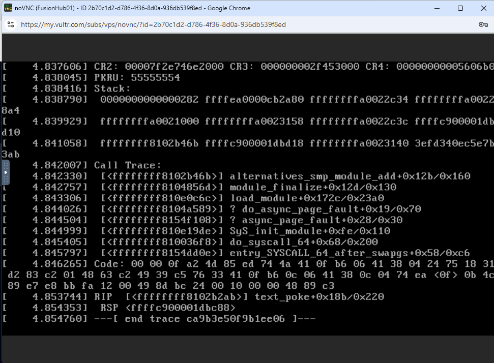

Attempting to install FusionHub on Vultr following the steps outlined above (thank you @ChristopherSpitler) . I have 2 instances I have attempted to get up and running, but I dont think either is completing the boot sequence even though Vultr has a public IP assigned and both report as running. FWIW I did reference the ticket requesting the UEFI be turned off, but Vultr says they cannot reference that ticket as it belongs to someone else. However, they indicate it has been turned off.
Looking at the Console as the VSP boots up, both seem to get hung up and never finish the bootup/start sequence. Not sure what this is supposed to look like, but most of these I’ve dealt with end up with some sort of complete/started message or a basic program menu. I have attempted this with FusionHub v8.0.1 build 1644 and v8.0.2 build 1656.
Any ideas?
So it seems @vigilant had the same issue, but there’s not a fix that was obvious. They said they waited awhile and it eventually would work. Unfortunately with the console UI they provide there’s no way to scroll up (that I’m aware of) so we can’t actually see what happened, only the end of the trace.
Trying again with new instance. Before requesting Vultr to disable the UEFI, this is the screen shot of the console. Looking for an .iso?
Progress?? Seems to be booting, but unable to access via web gui… IP’s backed out.
