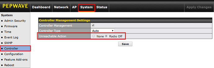

It looks like I missed this, it currently is a feature that we support in 3.6.0 firmware.
Thanks! Never considered looking at the actual APs. I was looking at the settings on the AP controller. Good think my network is small…

This is a nice feature – one that we also have missed as we manage all APs via the Balances to which they are connected – which is the whole point of having a controller, of course. What’s the chance of making this feature available via a page on the Balance??

Adding the ability to push the Unreachable Action via an AP Controller has been added to the road map. We do not have an ETA on the feature.
