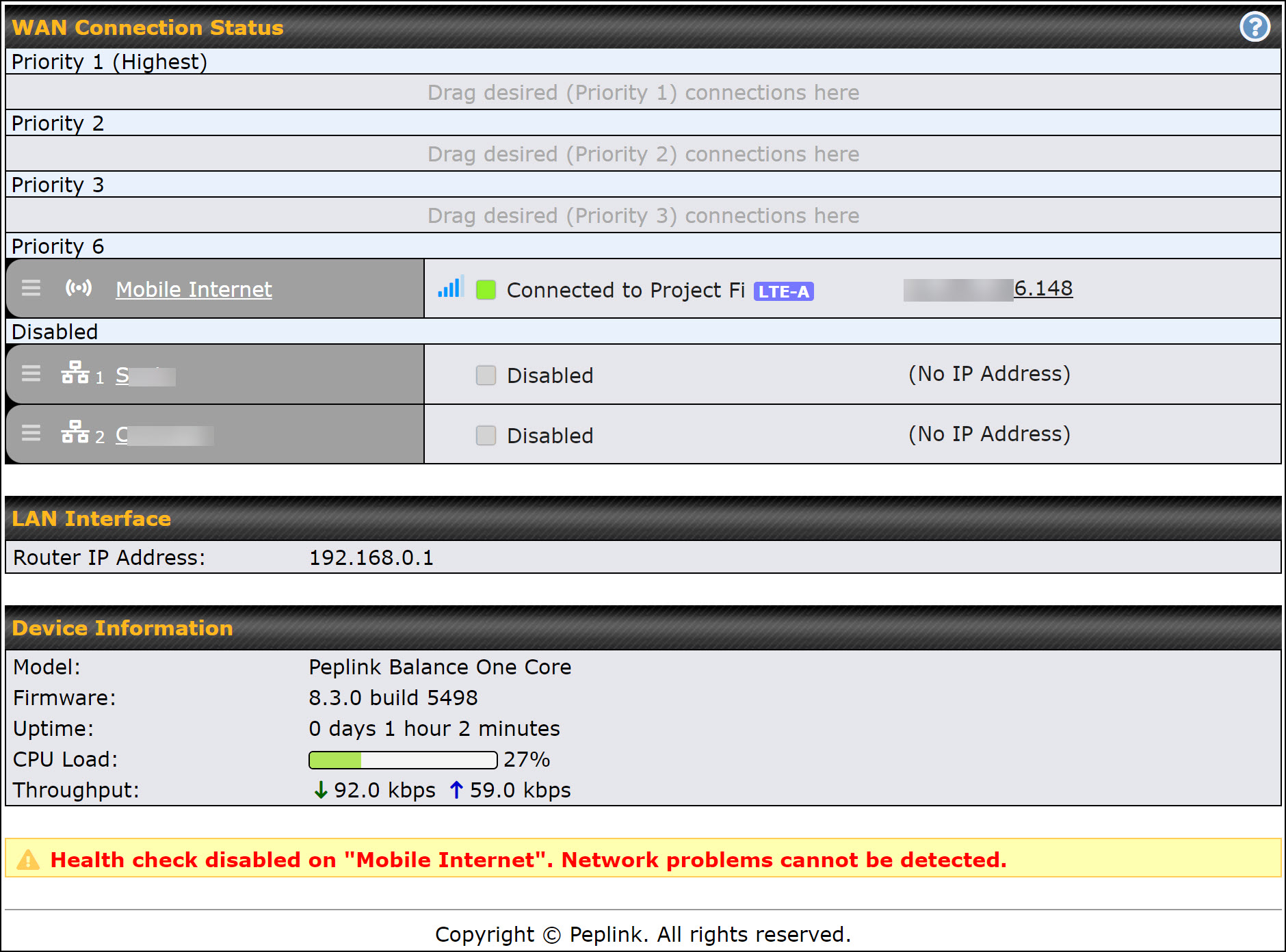

Thanks TK. This helped but did not solve the problem. With the beta hardware the router recognizes the modem and the sim and connects to the service. Ping from the router works fine, but ping from a client PC does not. (I tested with a minimal firewall that allows all outbound, block all inbound, no wan specific rule.) So the connection is still not usable. The two other connections I have work fine and with the usual speed.
What should I do next? For reference, just in case I missed something below are some screenshots.

Dashboard with new firmware:
