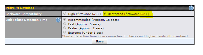

The option is available here. Please check the attached screenshot.

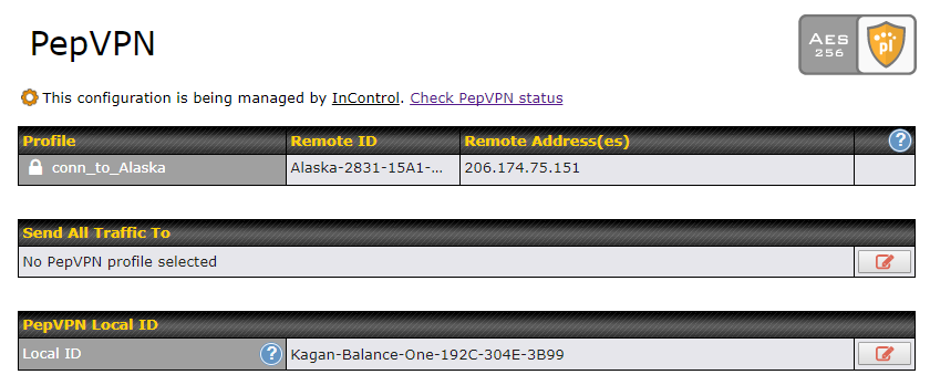

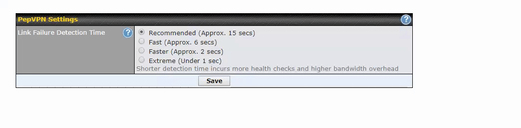

Here is a snapshot of my console
I don’t see that option. I also checked InControl console but nothing’s there too.
Below the PepVPN Local ID section on that page you’ll see a section titled PepVPN Settings. Click the blue ? mark in the title bar and then the link as per the screenshot above and the Backward compatibility row will appear.
I removed the current VPN profile and PepVPN settings just showed up.
so if anyone is having same issue they need delete active profile in order to be able to change those settings
