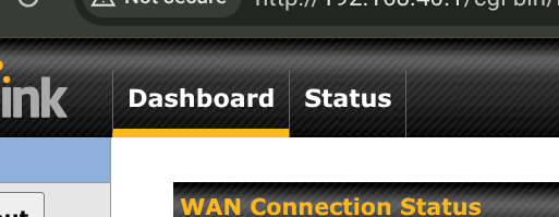

Are you see, something like this?
Can you share the dashboard of your device?

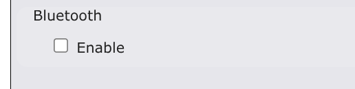

To check the bluetooth status of your device… you need to check at support page…
SAMPLE
Default url, after you do the login at the device
" https://x.x.x.x/cgi-bin/MANGA/index.cgi?mode=config&option=admin "
replace with
" https://x.x.x.x/cgi-bin/MANGA/support.cgi "
check at the bottom
Hello Marcelo.
Thanx for the quick reply. Bluetooth was fixed, thanx again. Funny that I only saw the transmition from an Android device but never from any Apple device.

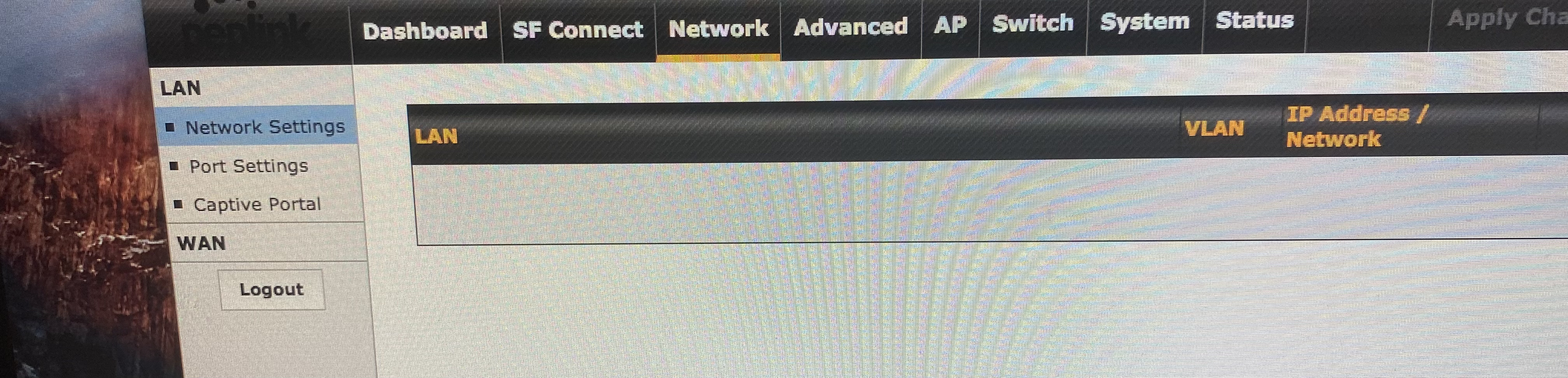

As for the Network problem, this is the pic. Upon clicking on it, one swirl and nothing after
I forgot to mention. Everything else is visible as always. Dashboard, everything. Just the network tab is ignoring me. Had MK3 previously.
Hi…
Using another browser? Same issue?
Have you try to clean the cache of the browser?
Hi Anas_G,
Could you confirm how are you connecting to B One? Directly via LAN port?
it is highly likely that a script is crashing in the background preventing the menu from populating properly
Was away, sorry for the delay. Changed browser, all visible now. Cleaning cache didnt do anything. I think I have what j16 describes. If this is the case, is there any fixing that?
Thanx to all for the hand.
Can you say more about what browser (with specific version #s and OS versions) were failing vs working? Something like "Safari 26.1 on macOS 15.7.3 worked, while Chrome 123 on Windows 11 24H2 failed"
Was using an OLD iMac 10.11.6, Firefox 72.0.2. Works fine with 26.2, latest Safari
