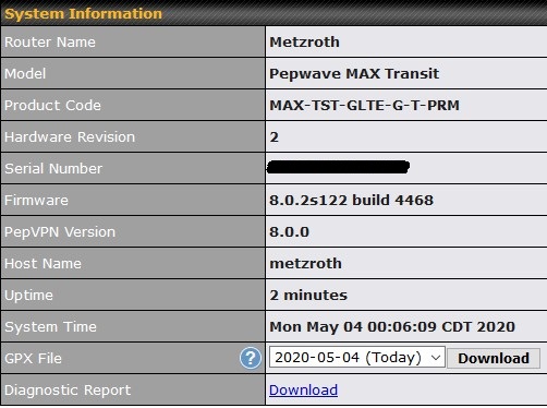

Can you share the product Code ?
Status —> Device
Up and running here. File appears to work. Might want to re-download it with another browser or something.
@Legionetz Thank you for confirming this.
Product CODE: MAX-TST-GLTE-G-T-PRM
Thank you, C_Metz…alternate download did the trick.
Thanks for this - I was just testing a CAT18 MAX Transit and had this issue. This firmware solved it, and I’m able to lock onto Band 71 for testing. Works great!
