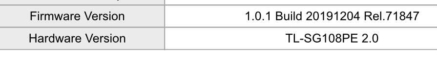

Wired through a cheap POE switch… TL-SG108PE
