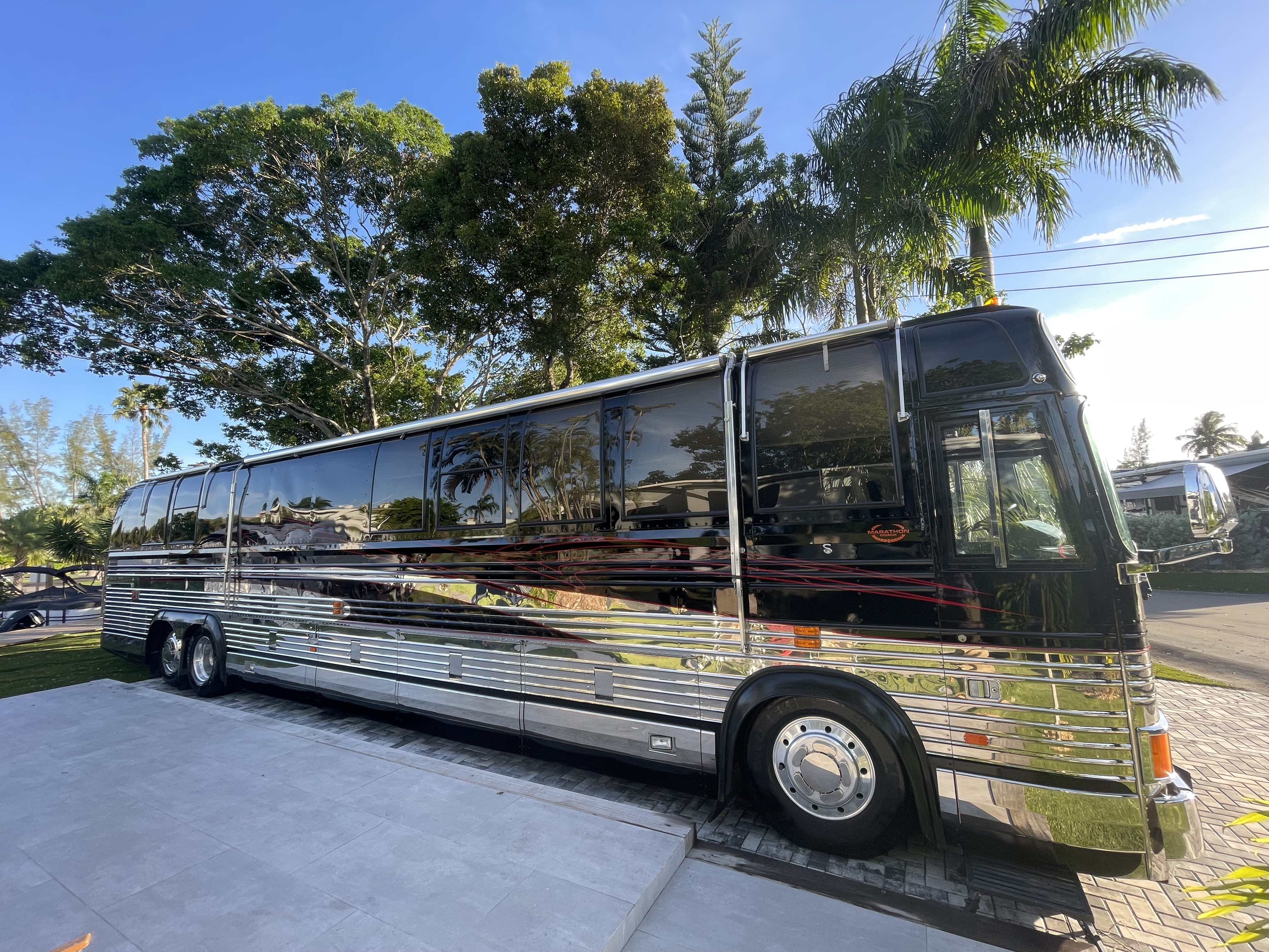

The Mako 9-1 is a fantastic product. I have it mounted in the center of my coach at about 10.5â above the ground. It is so tiny you have to be at an elevation above the coach to see it. I bought the accessory kit for either uneven roofs or thick roofs which was imperative to reach the extended threads on the inside to secure it. Itâs inherent sealing is based on a compression seal and I have verified through hurricanes and torrential rains that no water has ever leaked around the seal which keeps this serviceable instead of layering it with the âgoopâ that is required to seal typical RV/Marine roof penetrations. I have 2 unused, but terminated WiFi cables going to the roof antennas that I could, but see no need to, add another AP ONE Rugged to provide extended private SSID reach outside the coach. My antennas is at the back of the coach above the closet along with my network cabinet. I did verify through testing that I could NOT reach the front driverâs chair with sufficient WiFi using only the roof mounted antenna. The 45â length and stainless steel/glass added to the challenges. I use three Panorama surface mount antennas designed for emergency responder windows with 10â cable lengths mounted in various locations including one on the bedroom rear window glass which provides good coverage of the outdoors on the passenger side (camp side) and two more placed strategically in the back bedroom to provide coverage all the way up front. I am likely to add an AP ONE Rugged mounted in the cabinets above the driverâs seat with two antennas covering the indoors and one placed on the inside of the glass to better cover the front half of the coach and the outdoor area in front of the coach allowing me to drop the output power from high to half power. I am trying not to âpolluteâ the WiFi ecosystem where I park. A photo is attached for reference (1997 Prevost XLV Marathon Coach)
Thatâs good to know, many thanks again. That s some coach!
