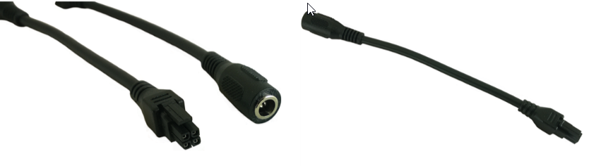

Hi Steve, you need one of these:
You can buy one here if you’re in the US.
