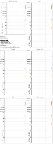

Since it’s 3 weeks till you can test again, I’m running 4940 on FusionHub and 4942 on Max Transit. I setup a 3rd sub tunnel so I have these tunnels configured…
  1. WAN Smoothing all defaults
  2. Bonded, FEC Low, 65ms cutoff diff
  3. DWB all defaults
All use T-Mobile and AT&T as #1 priority
All tests 20 second downloads
WAN Analysis tool
DWB
Bonded
If there is a test I can run or data I can provide while you wait, please let me know, RA is already active for a separate issue related to the cellular modem.
DWB is definitely getting better, I saw it burst much higher than bonded. My take on them currently… if you goal is highest throughout… DWB wins… if the goal is balancing the traffic and trying to load up both pipes, than Bonded appears to be better for making sure both pipes are used.

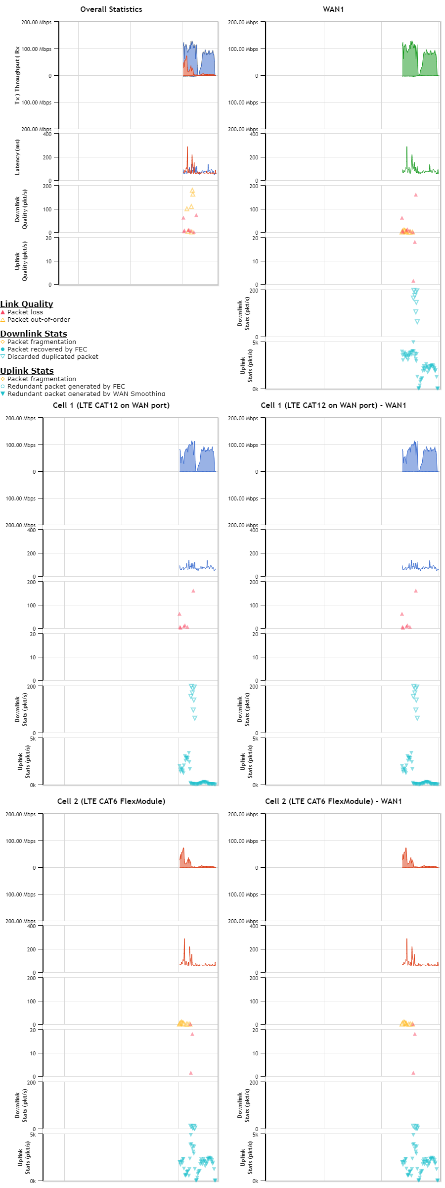

@Legionetz, you are using MAX Transit and the maximum capacity of SpeedFusion throughput is 100Mbps, you are hitting the hardware limit of the device but I have still tried to modify some parameters and you can see it’s more constantly running @ ~100Mbps now.
  • Cut-off Latency is set to 120ms to allow the latency inflate a bit more before the bufferbloat prevention logic kicks in.
  • Enabled “QoS > DSL/Cable Optimization” to optimize TCP ACK handling.

Dear All,
some update.
The remaining “missing” bandwidth compared to the 100 Mbit/s limit of 20X comes from # of parallel TCP streams. Left bar shows SpeedFusion with 4 streams, the right bar shows with 1 stream:
I learned that with real traffic (not the testing tool), even a single stream would reach the 100 Mbit/s.
Thanks a lot for @Steve for this final analysis and to everyone who helped me with advises.
Overall I pretty much got what this product promises and happy with it.
