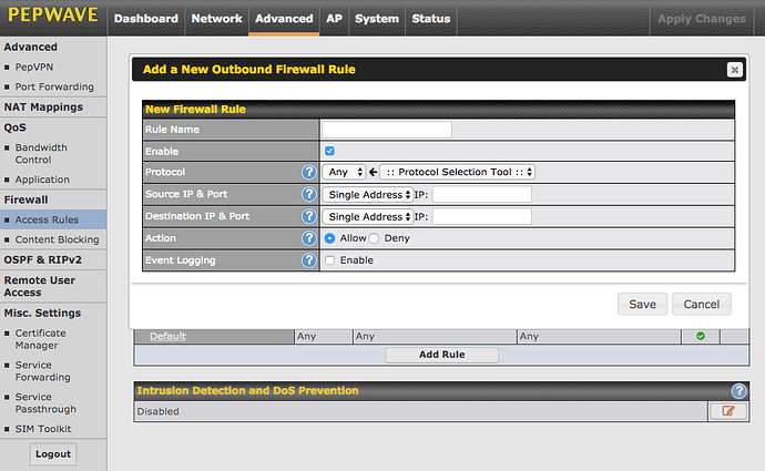

Hi! I’ve just begun using the Pepwave Surf SOHO MK3, 6.3.3 build 1068. I would like to establish firewall rules according to IP addresses and ports. The manual for Pepwave Firmware 7 (January 2017, p. 68) shows that there are two lines, one for the IP address and a second for the port. But my firmware (see screenshot) only has a line for the IP address, and I cannot see a way to enter the port number. How should I enter a port number?

Could someone please help me with this? This surely isn’t too difficult a question for experienced users. Am I not seeing something that is obvious, or is there a format in which to enter the port? Is a firmware expert out there who could help? Please?

This is the old firmware WebUI display issue. Please upgrade the device using latest firmware and you should get the correct WebUI display.
Sitloongs, thank you very much for your reply! I also realized that my firmware is outdated, and upgraded it to 7.1.0 build 1284, but I still don’t see a place to enter a port number.
You need to specific the “Protocol” to TCP/UDP inorder the port fields to show.
Thank you, sitloongs! That solves it!
