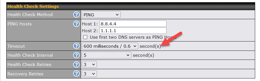

How can I configure things to automatically route traffic to WAN1 if WAN2 slows down too much?
Well, if the slow connection that causes you pain is accompanied by an increase in latency you can change the health check parameters from the default. One of our customers has a similar situation and has reduced the Timeout parameter well below the default, as shown below. We’re told this solved the problem for them – after a bit of experimentation. In this case once ping responses exceed 600ms the subject WAN will be marked as down.

Thanks, I’d forgotten about the health check settings. I’ll try playing with those and see if it helps. Does the router log an event if the timeout is exceeded?

Hi @jeff . Yes, when the WAN goes down to health check failure the event will be recorded in the log seen at Status → Event Log.
