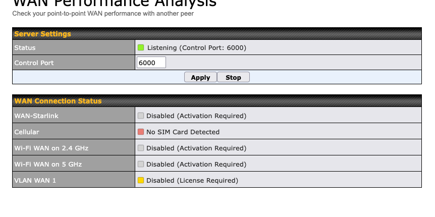

How did this happen?
Woke up here, to nothing connecting on my WAN ports??
I put in a trouble ticket, but no responses as I’m down without WAN
Poking around, I see this…
How did all my WAN port go deactivate, and how do I get them back?
Thanks

The fact it says “License Required” and “Activation Required” would lead me to guess somehting like a BR1 Mini which requires either the feature pack license or an active PrimeCare subscription for those ports other than cellular to be activaged for WAN use.
Did PrimCare lapse on it, or has it become deactivated somehow?
Yes, A BR1 5G mini.
I actually didn’t know anything about additional licences. I did understand that there’s a license on the extra WAN port (which I didn’t need) and a license for remote services (which I didn’t need also), but I never in my wildest dreams thought that the router goes completely’ paper weight’ unless you buy licenses??!! WTF.

Take the serial number and feed it into the search box on the Peplink eStore.
https://estore.pepwave.com/
That will give you a shopping list of addon licenses, in the case of PrimeCare you may hit a little snag where it needs to be online to call home to get its licence for the ports reactivated and it looks like you don’t have a SIM installed… the feature pack you will get a licence token to feed into the Web GUI.
You probably want to consider one of two choices:
  1. Add the feature pack that perpetually activates the Ethernet WAN and Wi-Fi WANs and some other bits (MAX-BR1-MINI-LC-FP).
  2. Add a PrimeCare subscription, which includes the bits from the feature pack plus the remote monitoring / management via InControl2 and also renews the hardware warranty on the unit - 1/2/3 Year options available.
Without going too much in to the product stack and Peplink’s choices on pricing structure, the BR line are moble cell modem first, router second(usually vehicle mounted or installed in outdoor enclosures, that kind of use, it’s why they have such a wide operating temperature range). Some features are always on but some are either tied to the Primecare subscription or a feature pack unlock. A few years ago they added 1 VLAN free with all care packages and/or additional perpetual ones for $200 a piece.
https://estore.peplink.com/ go there, put in your serial number and it will tell you the available choices specific to your exact router.
Things to watch for:
  • PrimeCare vs Primecare +, the plus is often cheaper if buying multiple years and adds cross shipping on the device warranty.
  • There should be a feature unlock for your router (probably MAX-BR1-MINI-LC-FP) that unlocks the WAN port, WIFI WAN, some speedfusion stuff and GPIO. This is the permanent unlock for these if you don’t care about incontrol or extended warranty.
  • If you do not get extended warranty, you don’t get a VWAN free. You can buy one with LIC-VWAN or 2 or 3. The popular route is to buy LIC-VWAN, then buy that same code again to add +1 to the total VWANs as needed, up to 3 on this device.
Sorry to be the bearer of bad news here but your sales rep kinda dropped the ball here. For router use without a cell modem the B One would have been a much better choice. It has a cell modem option if you want it, but it is a router first and has 2 WAN/1 USB WAN/2 WIFI WAN active perpetually.

I bought the 99/dollar feature pack just to get it back to normal and NOT be a brick as I’m currently NOT using the sims, but I will be soon once on the road.
