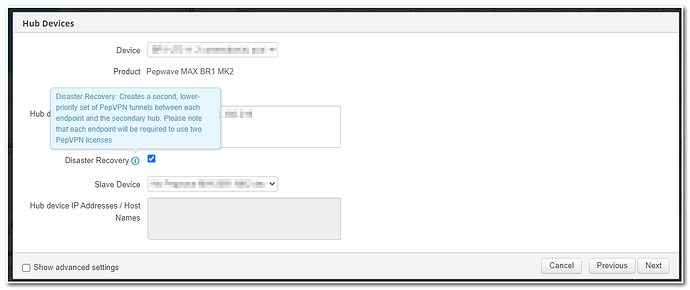

In addition to @sitloongs reply, if you use InControl to configure the Speedfusion profiles you can use the disaster recovery" option.
