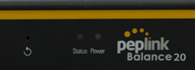

There are 3 ways to factory reset the device:
- Via device level Reset Button or LCD panels:
Lower end models:
Higher end models:
Maintenance
Reboot > Reboot? (Yes/No) (to reboot the unit)
Factory default > Factory default? (Yes/No) (to restore factory defaults)
Via WebAdmin
Via IC2:
Your request is more on item 1 above for the physical reset button ? Would you able to share more for the concerns and the use case ? More on the physical security concerns ?

Not to be too facetious, but plugging the reset pinhole with superglue might do the trick.

In many of the higher end models that have the LCD display (such as the Balance 380, 580, 710) for doing a local reset, the reset feature can have a PIN applied. In this situation if the admin password is lost and so is the PIN and the unit is not managed from InControl2, then the unit must be returned to Peplink for restoration of the unit back to factory.
We currently have a customer in that situation, they have lost the admin password & reset pin and the unit is not connected to InControl2 (disabled within router), so they are unable to make any changes.
Without knowing the technical design of the models, here are a couple of possibilities to consider.
- If the Reset is a hardware initiated process independent of the firmware, then the only option is to block up the reset pin as suggest by @zegor_mjol.
- If the Reset is a processed based reset done by the firmware, then there may be an option to add an optional additional security layer around this where an additional step needs to be taken using some form of security. What if within the unit you could choose the option to secure the reset with a Reset PIN (between 6 & 16 digits), then if a factory reset is initiated with the reset button, the unit can boot up with an intermediary factory configuration, this configuration would allow a special web admin (with the WANs all on default and LAN set to default) that can also be accessed through InControl2 (if the device has a current subscription) where you have a grace period of say 10 minutes to log into the device and verify the reset PIN to completely reset the device, else the device will reboot back to the previous working configuration.

Open the unit
De-solder the button assembly from the motherboard, takes about 15 seconds to do it
close the box again
Done
if you ever need to reset it, open the box, short the solder points with a flat screwdriver, and there you go.
Factory reset is built into the EPROM bootstrap, even before the bios loads, so unless they would make you a physically new unit without the button (which again can be defeated by just shorting it with a flat head screw driver even if they physically removed it) i don’t see how else they could do it.
