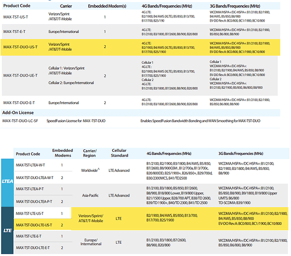

Also, is MAX-TST-DUO-LTE-US-T equivalent to MAX-TST-DUO-US-T? The product code on my unit does not carry the “LTE” designation.
Yes. the LTE designation was added when CAT6 modems arrived to differentiate between the CAT4 and CAT6+ (LTE and LTEA).
I have copied the old and then new list of SKU tables below.
