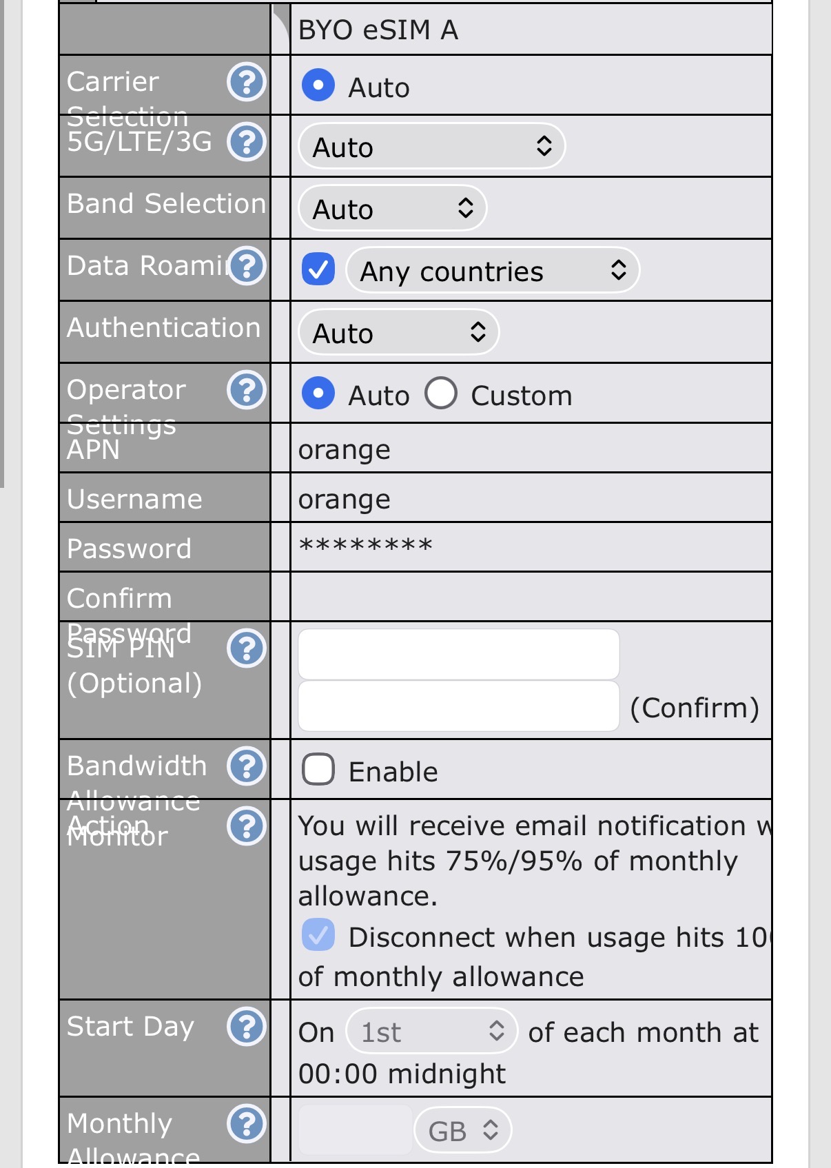

I’m using an esim under BYO esim, and that works perfect in the GSM network of The Netherlands, Belgium, Portugal and Spain. But in a lot of parts in France, the esim gets stuck on “Connecting”.
The 4G/5G reception then, is almost always 80-100%.
All esim network settings are set to Auto.
Roaming is set to any country.
Tried forced LTE network only, no effect.
Tried Dynamic DNS settings to OFF, no effect.
Tried to reset the cellular modem, no effect.
Tried manually change to another carrier, no effect.

The esim gets its APN automaticly as soon as it is online. Can’t think of any reason to change this.
(See attachement)
Roaming is also set correctly at the BYO esim, as “Any Countries”.
Proof of correct settings, is that the esim works in a couple of parts in France, and in all the countries outside France. Then the same “Auto” settings and APN are applied.
