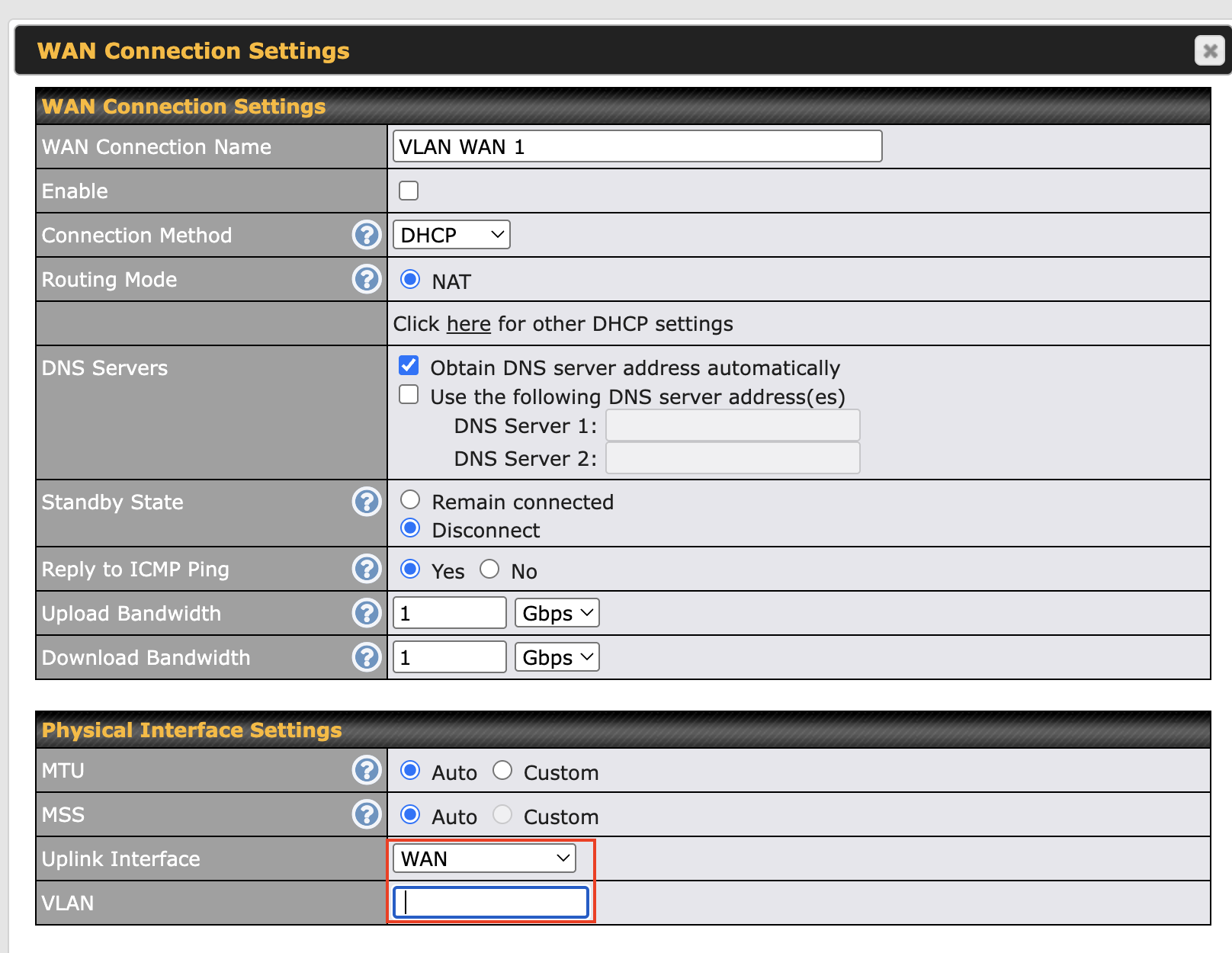

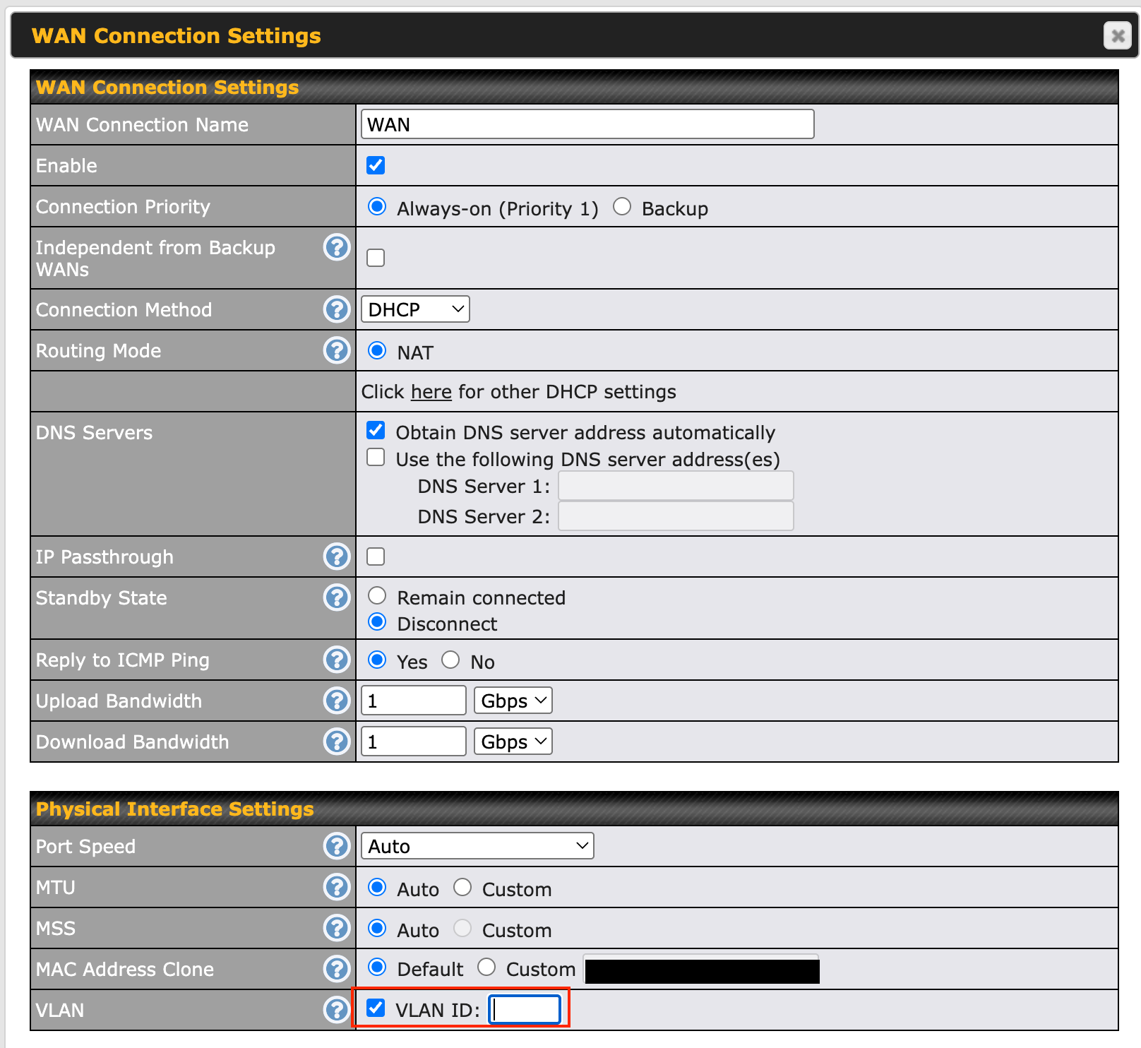

Yes, you should be able to do this assuming that you have the BR2 under a prime care contract or have a license for a VLAN WAN.
The cable would connect to one of the physical WAN ports, you can specify a VLAN tag for that WAN to use for its traffic.
The second one would be configured under a VLAN WAN interface, you would specify the same phsyical WAN port and again just configure the VLAN tag required.
