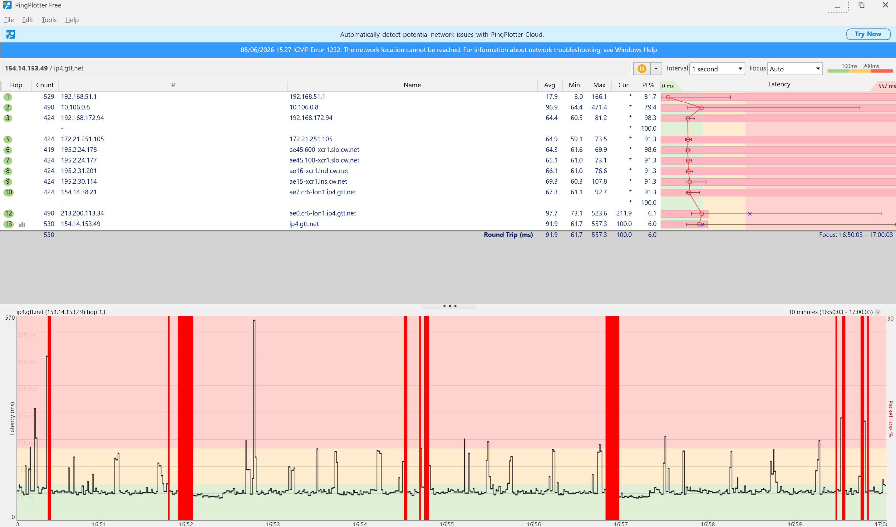

Should I expect that in these conditions I get packet loss on the local Acces Point AP?
-Speedfusion connect protect SFCP
-WIFI wan on Cellular
-WIFI Wan on & 2.4ghz . Disabled 5ghz wifi-wan.
  • Clients connected to local Access Point on 5ghz
  • I disabled any other SSID not required
If I plug into RJ45 port to SFCP there is no problem. It seems like packet loss is introduced whenever the wifi-wan client experiences instability. Even if I separate the frequencies. e.g. WIFI wan on 2.3ghz and Access Point on 5ghz.
If so, this means I need to buy another access point/router for the AP.
Disappointingly I find that even with both the WIFI Wan radios disabled, I still get latency spikes on the AP.
As tested against
-rj45 cable - you’d think this means radio interferance, but :
-using another low-tech wifi 4, 2.4ghz wifi router plugged into the Peplink via rj45 as this does not get the spikes.
I even tried disabling all SSIDs except the one I was connected to in case there were broadcast frames causing a problem.
Could regional settings be an issue? I’m currently testing in Spain. Unit is set to USA although changing it makes no difference.
thanks!

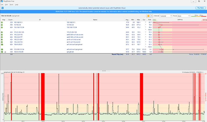

I switched to 20mhz and on a clear channel. The previous auto setting was on 80mhz and all channels were clear too. . I switched half way through this time chart. I don’t get problems connecting to my phone’s wifi hotspot on 5ghz and I have tried both 2.4 and 5ghz AP modes on the peplink
