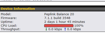

No, all the time. I was able to login and look at the device and it shown 100% usage. . peplink-cpu-100. I also have network monitor on our network but our network seems not down while this is keep goes on and off.
