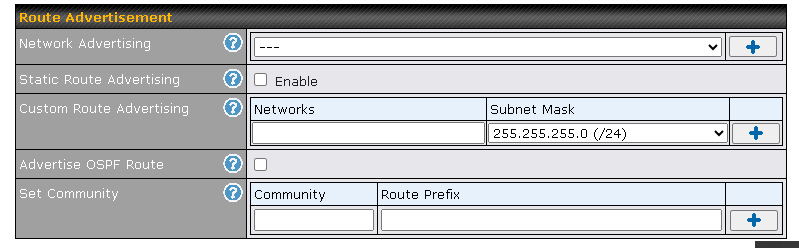

Hello, @mjosephson
Using version 8.6.0 at bpl-two.
Look the image below.
Yes… You need to configure it.
Not sure where you indicating but the only Prepend I see if for the entire ASN, not a specific route.

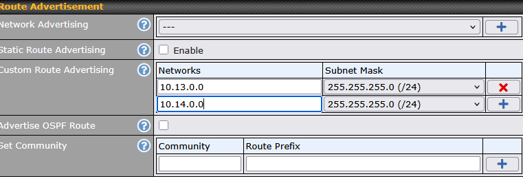

example if I have the following routes
10.13.0.0/24
10.14.0.0/24
yes I can prepend to my neighbor with adding prepend in that box but that would prepend both /24.
I just want to prepend only the
10.14.0.0/24

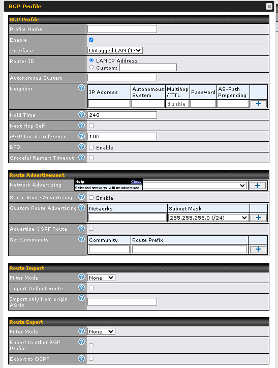

At your device go to Dashboard > Advanced > BPG > New Profile.
This wil be your starting point.
You can find more informations about this at
https://manual.peplink.com/peplink-balance-and-mediafast-firmware-manual/
From the manual
AS-Path Prepending: AS path to be prepended to the routes received from this Neighbor.
Values must be ASN and separated by commas. For example: inputting “64530,64531” will prepend “64530, 64531” to received routes.
This is the only thing in that doc that is say prepend. and its for received routes.
Again back to my example
10.13.0.0/24 (AS Path 65001 ← prepend for this route)
10.14.0.0/24 (AS Path 65001,65001,650001 ← prepend for this route)
Advertisement…
Both routes are going to be sent out to the neighbor.
But each have a different prepend set for each route.
You screen shot does not have anything for changing that. Hence the original question.
