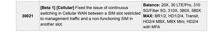

One thing I noticed was:
It’s possible your issue is similar and also resolved? RC3 just released so it’s going to general release, final soon. So you could always wait a week or two for the final release.
That looks like it possibly could be a related issue of interest. I’ll be watching for 8.4 stable then, thank you for your help. If that doesn’t solve the issue with the max adapter, i‘ll return it as defective and try another.
