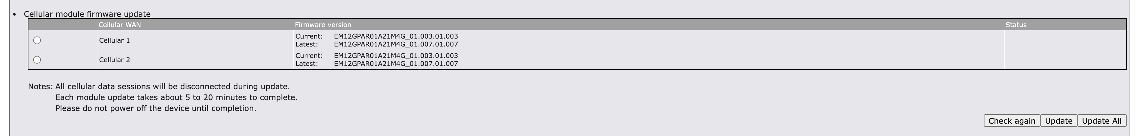

Also Is there a way to update the firmware on the modules? And I am using a Peplink E-SIM on the 5G modules but can’t seam to use Peplink E-SIMs on the LTE-A modules or I am missing something ?

Yes, log into your Peplink and go to the hidden support page. If you access your peplink via 192.168.1.1 once you are logged in change the URL to be 192.168.1.1/cgi-bin/MANGA/support.cgi (you can also do this via remote access through Ic2 with the same URL change) on that page you should see options for checking the firmware version and requesting an update.
