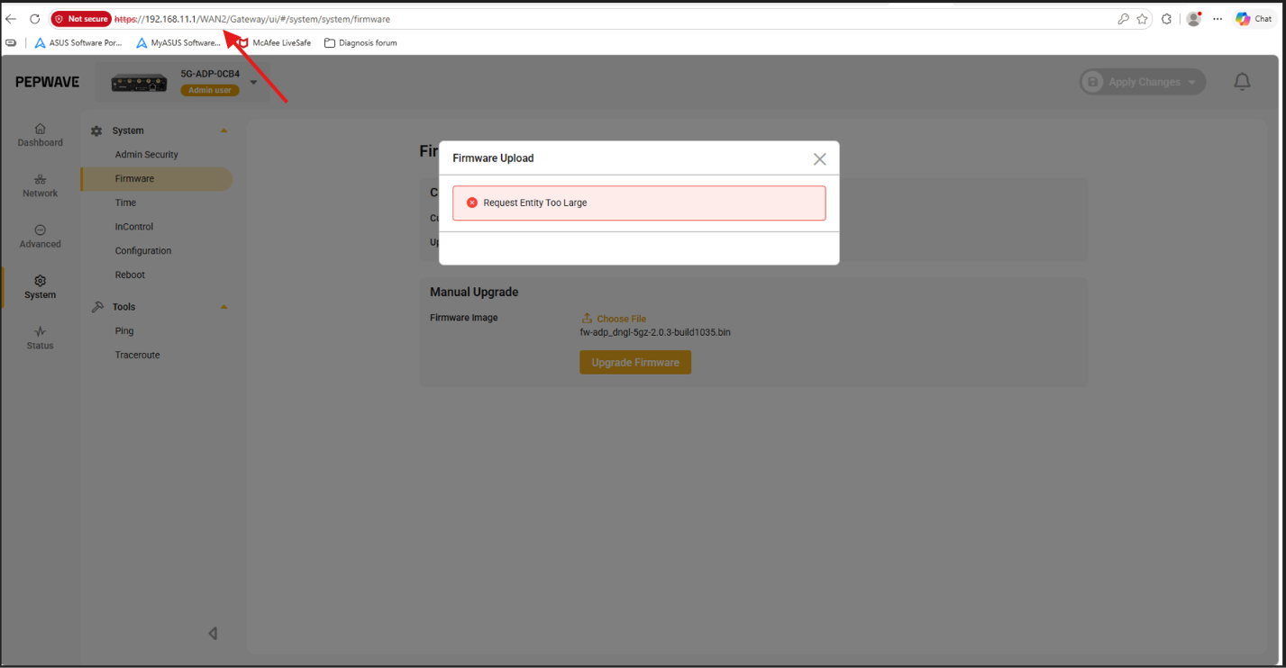

I’m running the 2.1.0 beta on my 5G Adapter. Trying to upload this new firmware results in an error “Request Entity Too Large”. Any suggestions?

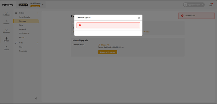

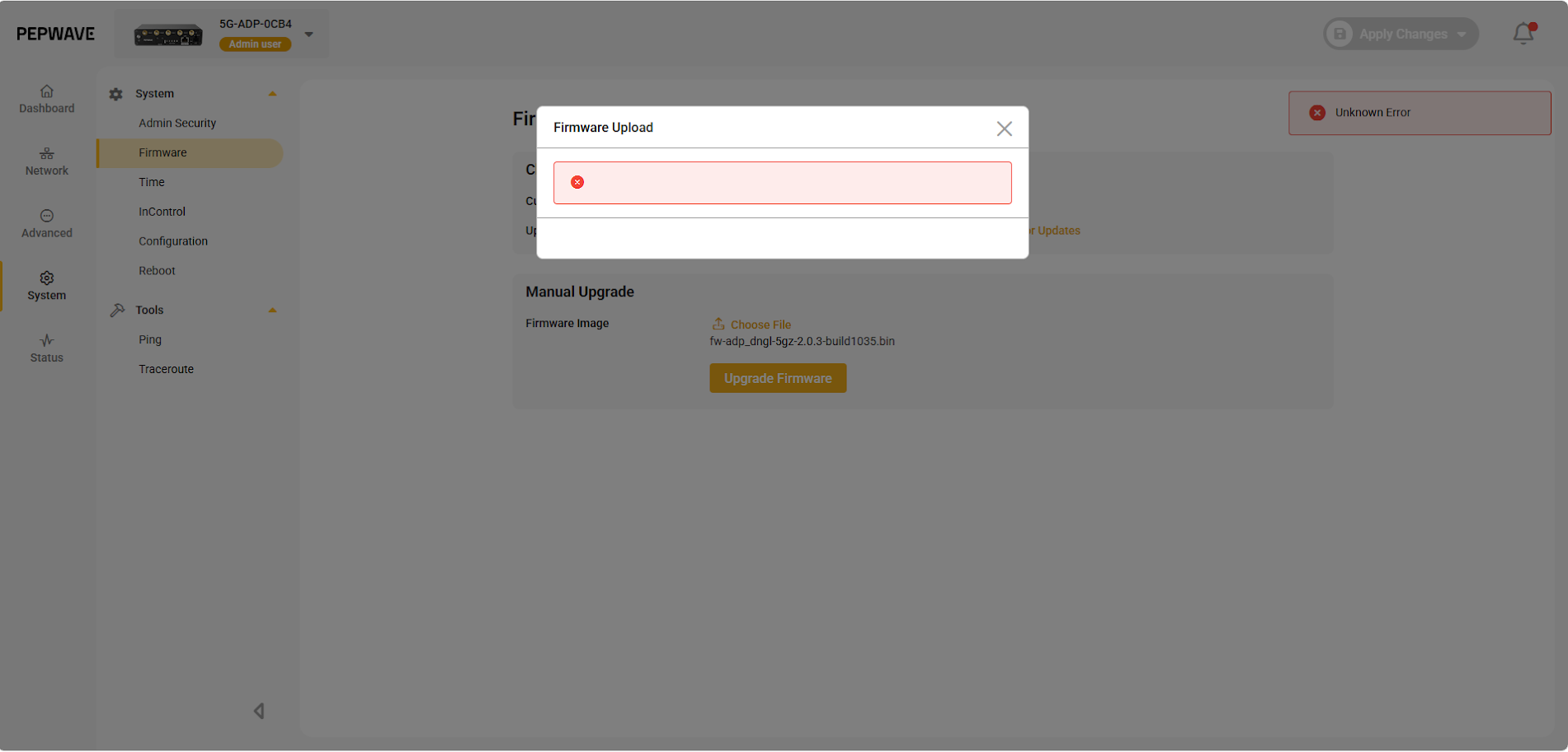

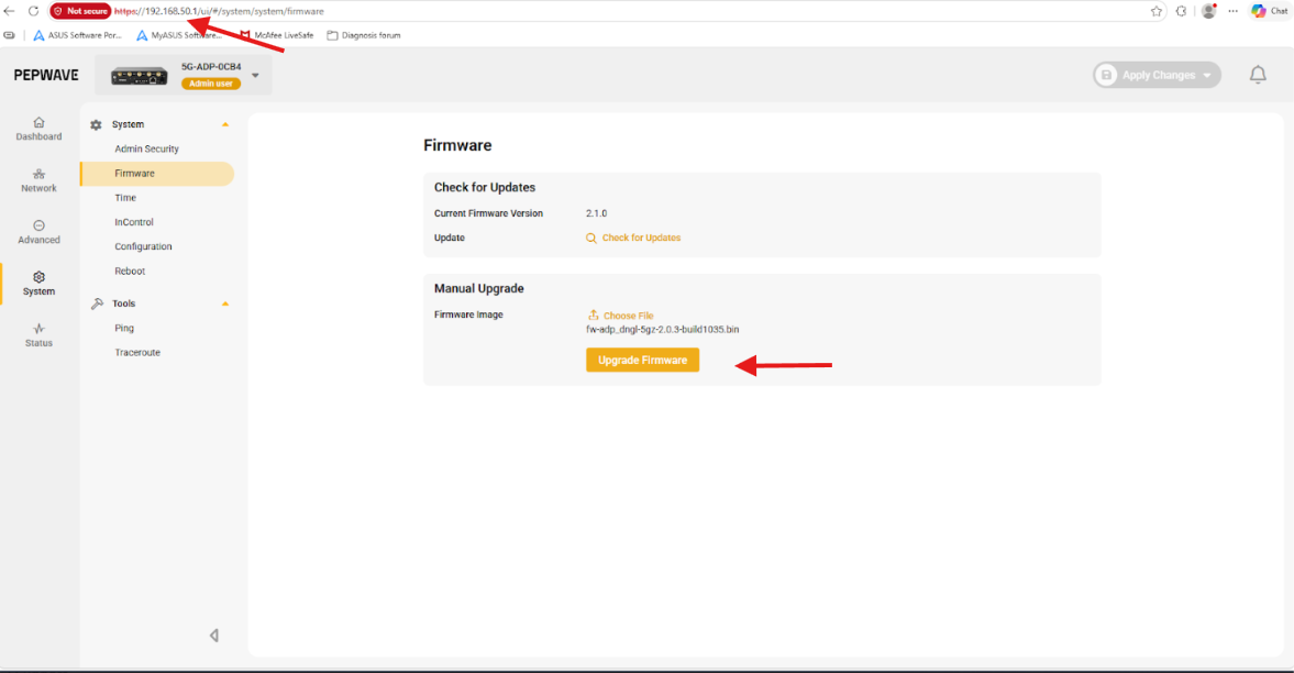

@Steven_Joerger - I finally got the adapter to upgrade, adding what failed and finally works incase it helps with troubleshooting.
Failed attempts:
Requesting upgrades via the UI
Scheduling upgrade via InControl
Local file upload connecting through the orbit 8 proxy to the local 5g adapter UI via Safari on Mac OS
Local file upload connecting through the orbit 8 proxy to the local 5g adapter UI via FireFox on Mac OS
Success
Local file upload by connecting directly to UI (not through Orbit 8 proxy) via Chrome.

I just tried using Chrome to upload a downloaded firmware file and it failed for me with the same error as before “Request Entity Too Large”. This is going directly to the Adapter which is synergized to my router.

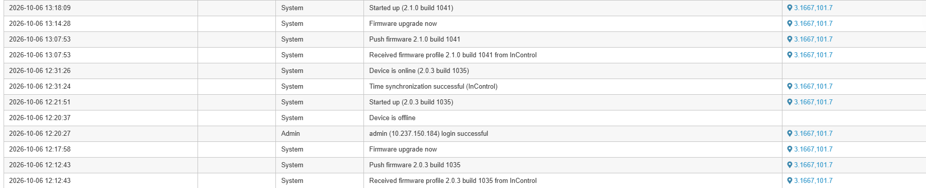

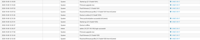

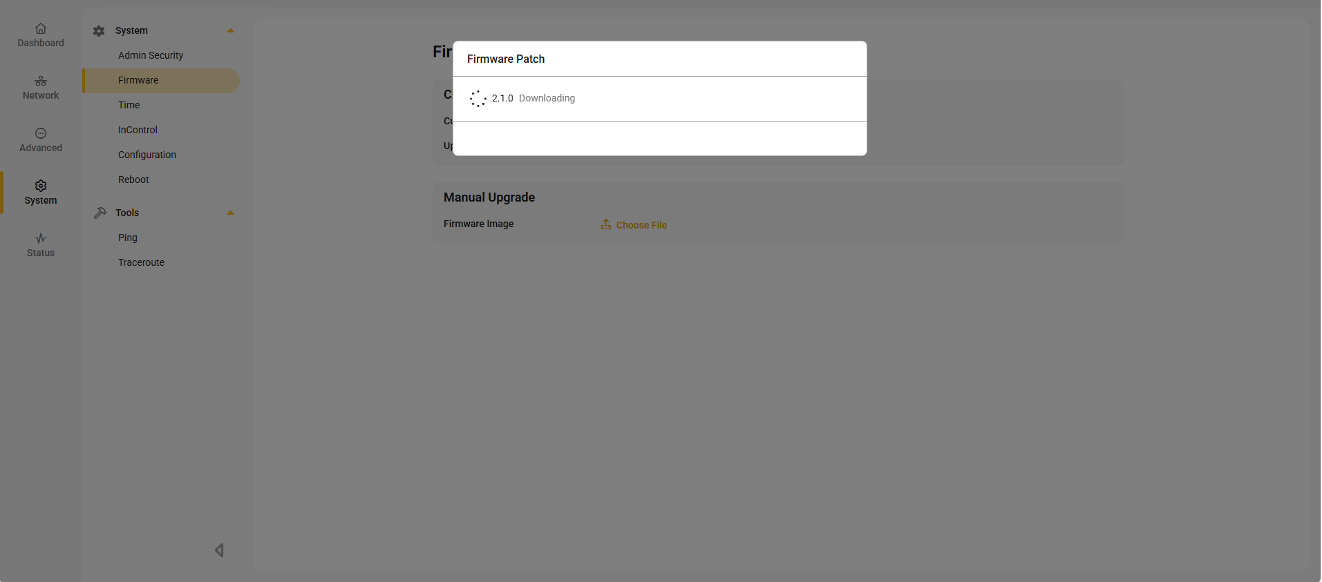

1. I tested the firmware upgrade using IC2 Firmware Management, and the upgrade was successful.
Please refer to the logs below:

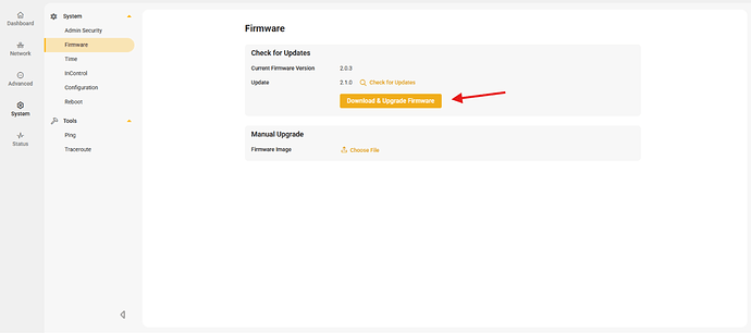

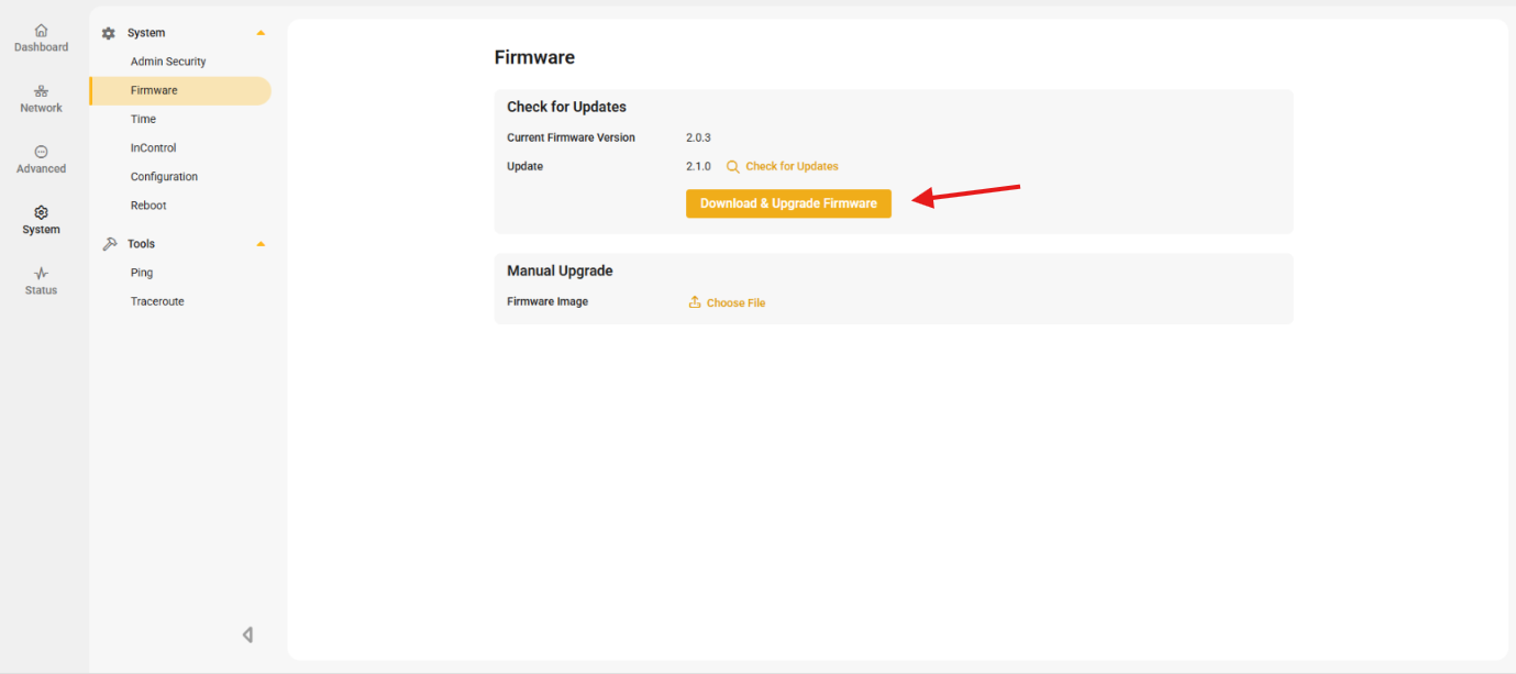

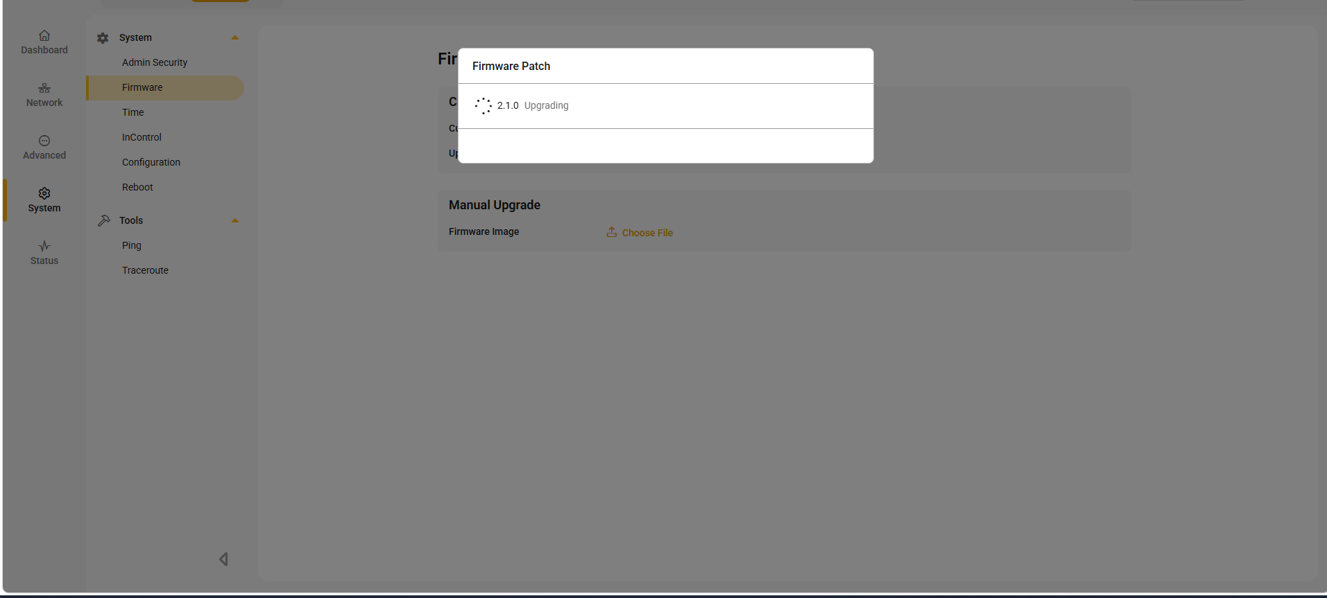

2. I tested the upgrade using the Firmware Check option, and the upgrade was successful.

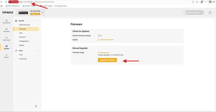

3. I tested the upgrade by direct connect to the LAN port and access the WebAdmin Page and the upgrade was successful.** | Manual Upgrade
  1. Via a Another Peplink device proxy option (Device is connected to WAN2 for another router)
  • The upgrade expected to have issue as there was a restriction for the firmware size via the proxy access.
